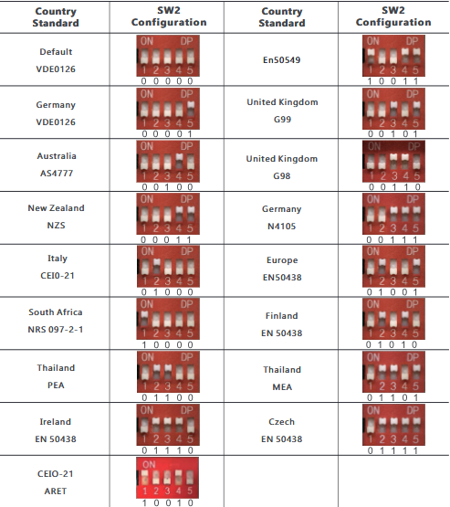

@plugwash does make a good point, the three types of inverter he lists, would require different answers, years ago on a narrow boat my son used the inverter as an isolator from the shore supply, the supply went through a charger class II to the batteries, and from batteries to the inverter, 3 kW with 6 kW peak, so the boats earth was not connected to the shore earth, to save the sacrificial cathodes from needing replacing so often.
And in this case the inverter did feed the consumer unit directly. There are so many variations on the use of inverters, if asked about a LXP HYBRID INVERTER for example you can down load the instructions, and see how it is set up. 1733394582898.png gives the country set up, and really for the answer it needs to be asked on a French forum.

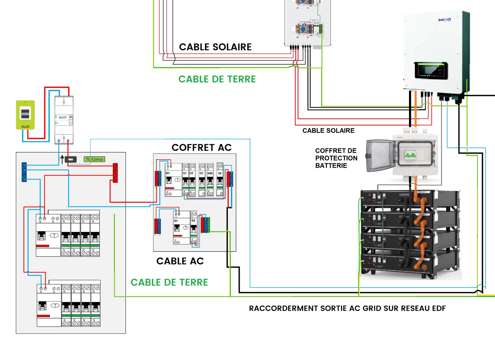

Understand it’s difficult to give a definitive answer, perhaps this schematic will throw some light on it….this is my installation and the tails from the AC unit are not going to the MCBs….the main difference I found here is there is no ring mains, only spurs and each white goods has it’s own spur. The inverter is ONDULEUR HYBRIDE 6KW - DUAL MPPT - HYD 6000-EP - SOFAR

So you have a grid tie to edf and no auto isolation, so your install will turn off if the grid supply fails..... you still need an mcb to protect the cable from the solar install... the edf grid tie will have a fuse/mcb so should your own micro generation from solar.
Imagine if that battery stack had a fault and dumped to your consumer unit....with no mcb - feu feu feu
