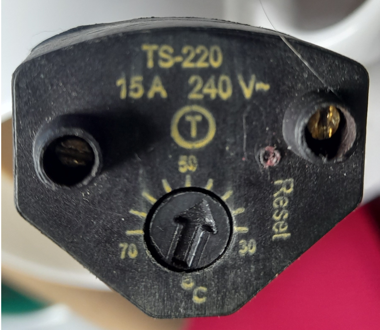

1748614790202.png The tank thermostat would trip the over temperature trip if set higher, so have renewed it, there was what looked like sealing compound on the new one fixing setting to around 60ºC it only goes to 70ºC, but I left it as it came. Water now only just warm enough, and clearly not enough to fill a bath, but don't really need that much hot water, but seems no where near 60ºC at the taps, so am I doing something wrong?

That’s looks like it’s set to about 45 degrees, need it hotter? Turn it up for legionella purposes too.
As above, it looks like maybe set at 45C, if that is the new one. Is it the correct length?
The sealed part will be the trip setting calibration. At the tap temperature will be lower, due to heat loss, along the pipe run.
Sorry that is the old one, new one was at 60ºC and there was a little sealant on it, so left as set. From the weeks read out, clearly using more energy, but both same length, which is rather short, and the power used is a lot lower than the immersion is designed to use, so does the low power cause the water to circulate less?
Moving from 45ºC to 60ºC I expected a massive change, but this has not been the case, hence the question.

Poke a bit of wire down the thermostat pocket, to measure how deep it is - it wouldn't be the first time, a too short 'stat had been fitted.

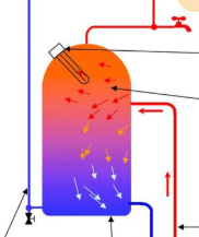

I can find explanations of how the Willis exterior immersion heater works, and I note the shape of internal types,
seems to put more heat towards the bottom, there are diagrams for combined heating 1748780745099.png and I remember the school experiment of rapping a block of ice in solder to keep it at bottom of test tube, and boiling the water at the top, theory is water at bottom will be 4°C as that is when it is most dense.
However the heating of the water must produce some thermals, so although the bottom of tank is colder than top of tank, there must be a mixture layer where water is part heated due to thermals moving the water around.

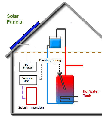

I would assume if using 3000 watts, the movement will be more violent than if using 300 watts? Most the sites show 1748781789467.png but that does not really show what happens when so little power is used, hind sight the iboost+ was not a good idea, a simple time switch would have been better, as paid 15p/kWh for export, and charged 8.5p/kWh for import, so would save money using a time switch instead of the iboost+ but now fitted, is it really worth changing?
So at 5 kWh per week, around 25 weeks of the year, as winter DHW heated with oil, 15p - 8.5p = 6.5p/kWh = £8.12 per year if the tariffs stay as they are, forget that, just found I can set it to work as timer, so set to heat in off-peak times. Although that does not seem to stop it heating when there is solar. But it means that £8.12 is reduced, so just not worth messing with.
