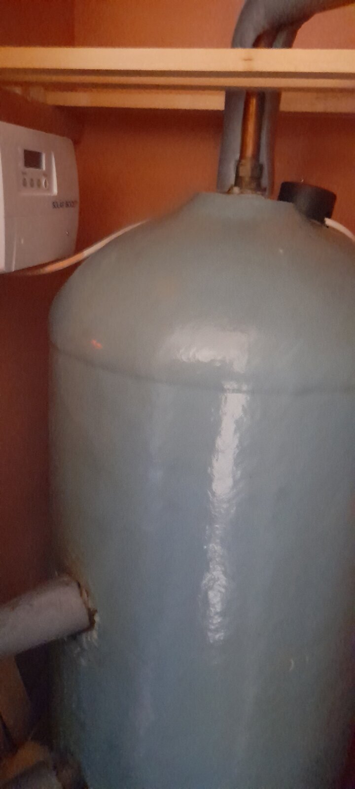

It had the standard spray on foam they come with, but open the airing cupboard door and the heat hits you. So added one of these 1751053392134.png1751053449734.png
1751053765223.jpeg Original as last picture. Not covered as neat as they show, but clearly going to retain more heat. However, as to how much it will save, that remains to be seen. So I am able to measure the kWh used, so once a week has passed I will give my findings.

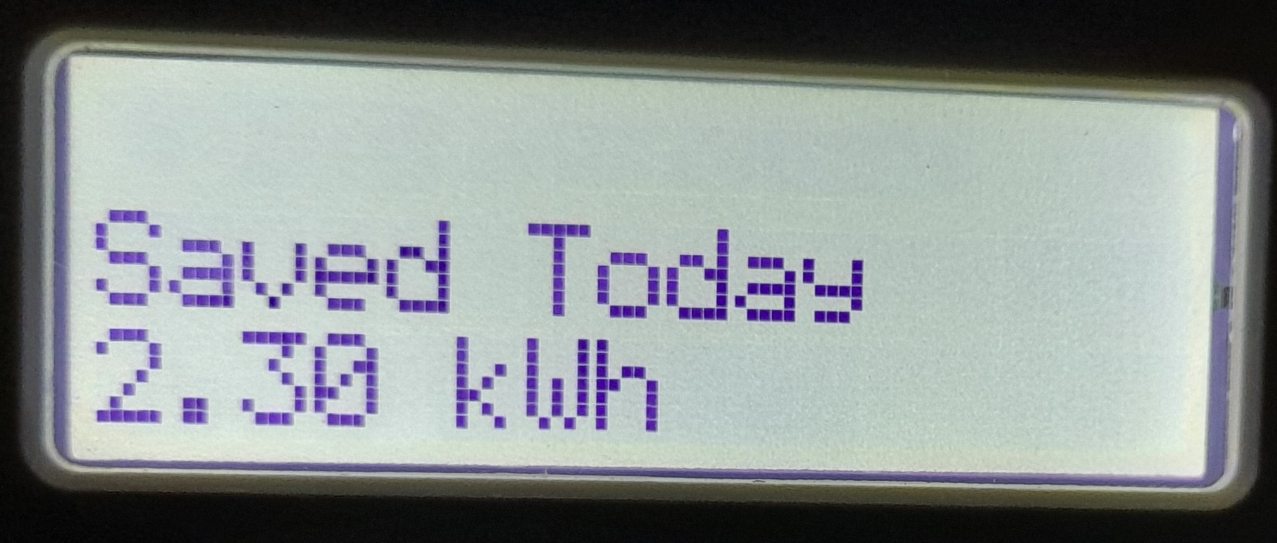

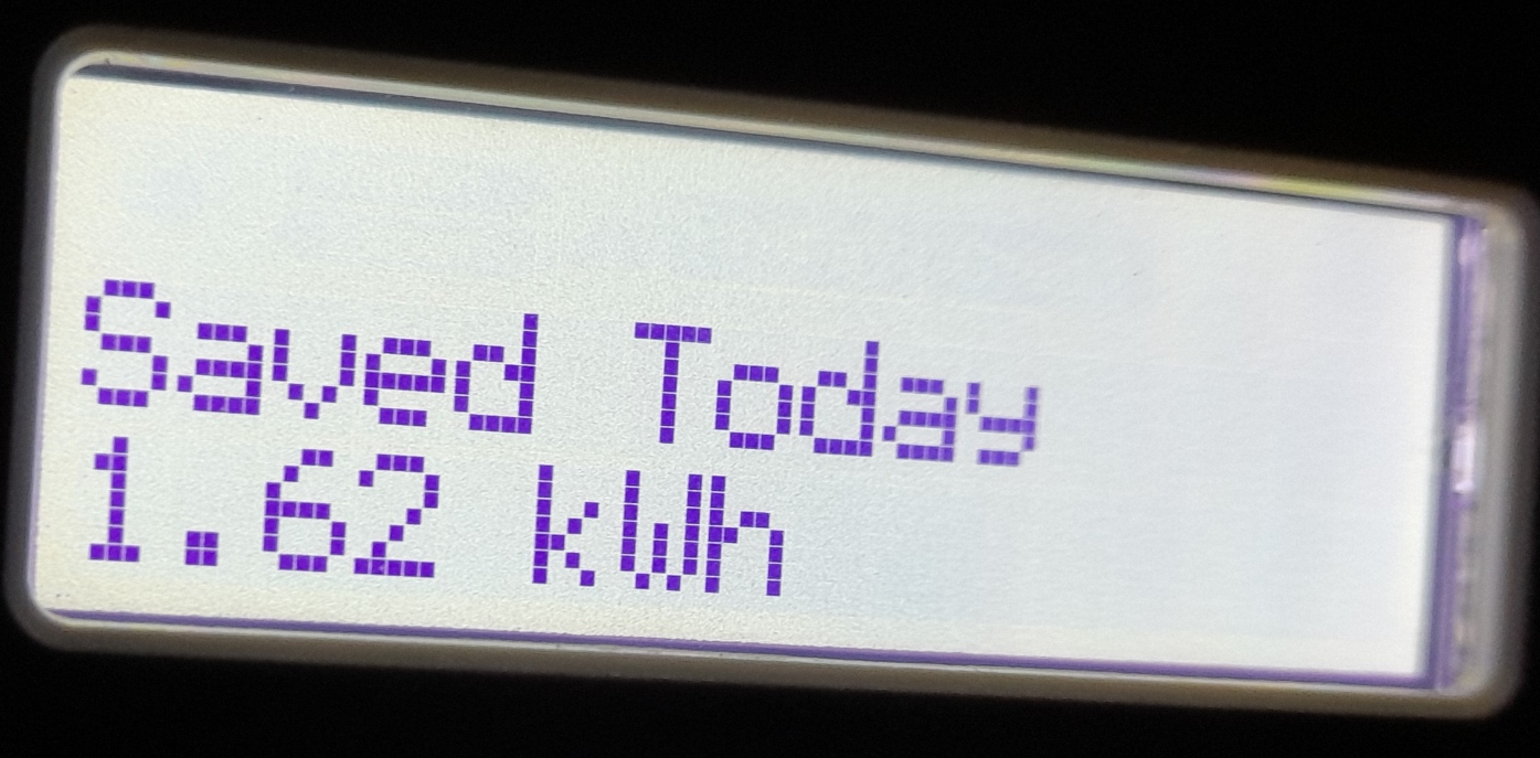

I have a coil, and it is C Plan, and no way to turn the hot coil off, so 1751117097176.png 16:54 yesterday and 1751117172247.png 14:16 today, clearly 2 hours still to go, and it does not take into account any hot water used, rather disappointing, I had hoped for a greater saving, but time will tell.

So 2.3 kWh to 1.8 kWh yesterday until 4:40 pm to today 4:40 pm, but one day is not long enough to be sure it is a true reading. If it drops to 10 kWh for the week, I will be satisfied.
