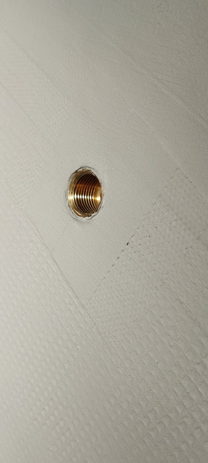

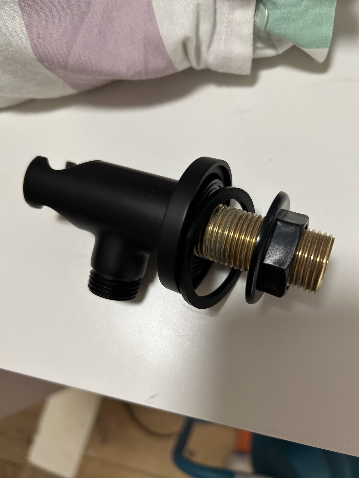

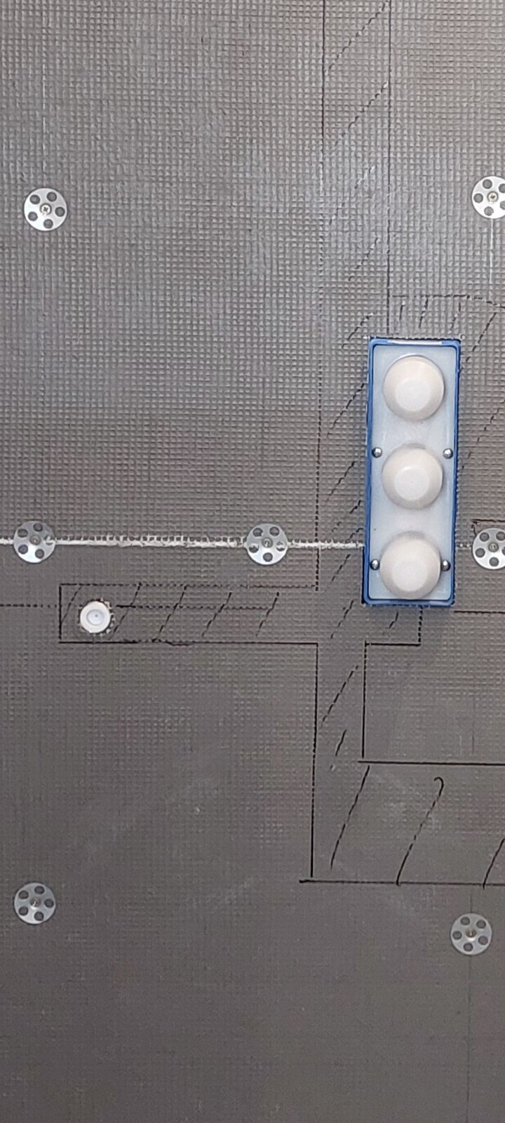

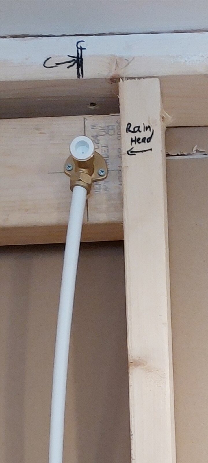

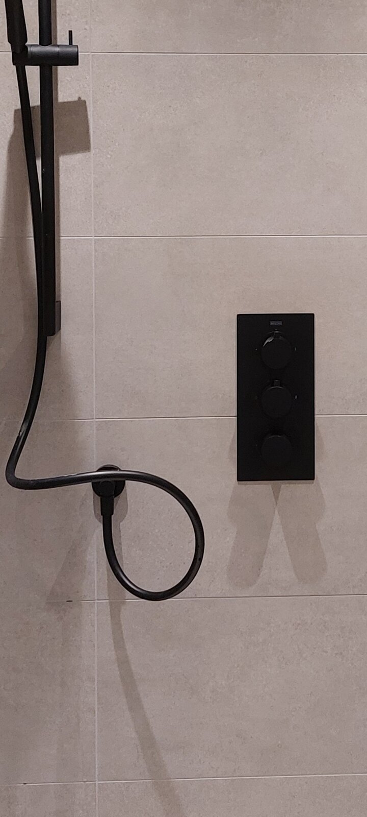

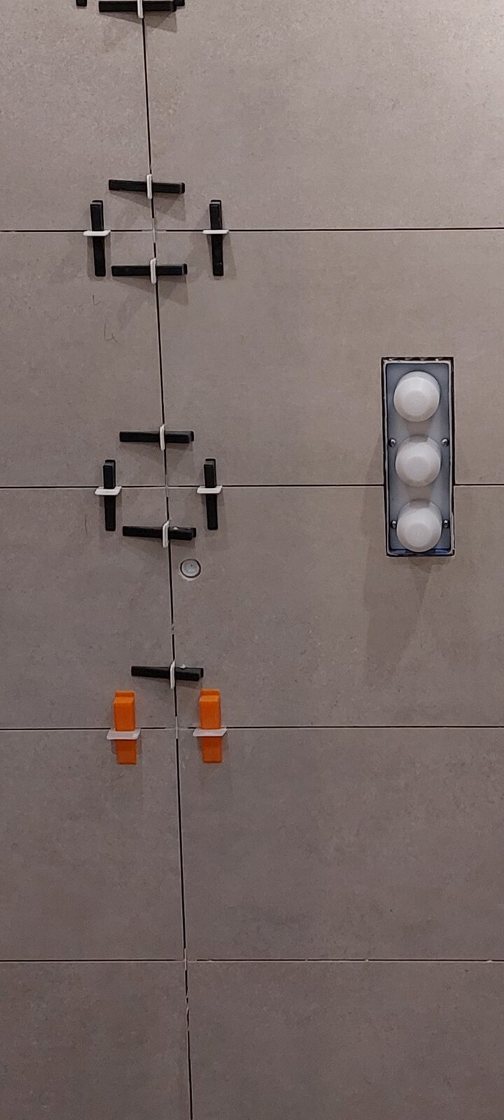

Hello there
Get these: https://www.screwfix.com/p/flomasta...-plate-elbow-15mm-x-1-2-/92934?ref=SFAppShare
Install it in position and have strong batten behind.
Then add backer board/elements board to the wall. With the connector flush with the face. Seal around the connector with silicone.
Then tank as normal
Tile the wall.
Fit the shower attachment, using loctite 55 thread. Seal behind with silicone.
You won't use the backnut in your case. And you may need to cut the threaded brass bar down to length to fit inside the connector.

Spot on, cheers.
I’m also thinking of tanking the walls first then putting the tray in and siliconing it to the tanked wall. This seems easier than masking it off like I’ve done in the past.
I like to lap the tanking tape slightly onto the edges of the tray, but yeah it's tricky
These are stronger .https://www.screwfix.com/p/highlife-bathrooms-round-shower-brackets-chrome/571HL?tc=PA6&gclsrc=aw.ds&gad_source=1&gad_campaignid=22605815174&gbraid=0AAAAAD8IdPw-vjsusW4PN6VBgruM7vWbG&gclid=CjwKCAjwkbzEBhAVEiwA4V-yqnMwK1XHopPMaDrUQJztxg-hBHT1Un5RzGNYGJVYMMhqLHv48yEfRhoCZjAQAvD_BwE
Seen those elbows snap at the screw holes which are weak .
