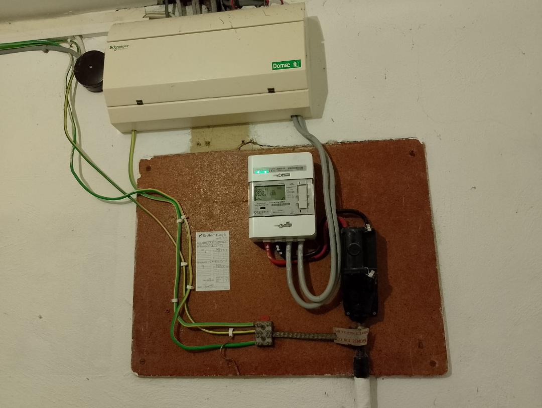

I'm planning on applying tanking slurry to this wall. Do I have to figure out a way to apply the slurry behind the electric meter and fusebox? I'm hoping there's an alternative like something I can inject behind the chipboard they're attached to. The chipboard is attached to some wood batons that are attached to the wall. The chipboard and batons aren't dry but they aren't rotting.

Hi Alex, I have the same issue as you. But building regs have said that I have to take the unit off the wall to apply the slurry (this will cost £6000!). How did you not need to remove the meter? Thanks
Moderator's note. This poster has his own thread on https://www.diynot.com/diy/threads/tanking-basement-wall-with-electric-meter.634770/
Hello, you answered 'yes' to this question a few years ago. i am now in this position. What alternatives are there as the guy from Building Regs has insisted that I have to take the meter etc. off the wall (cost of 6000!!). Please help :) How can we ensure it is damp proof without taking the meter etc off the wall?
