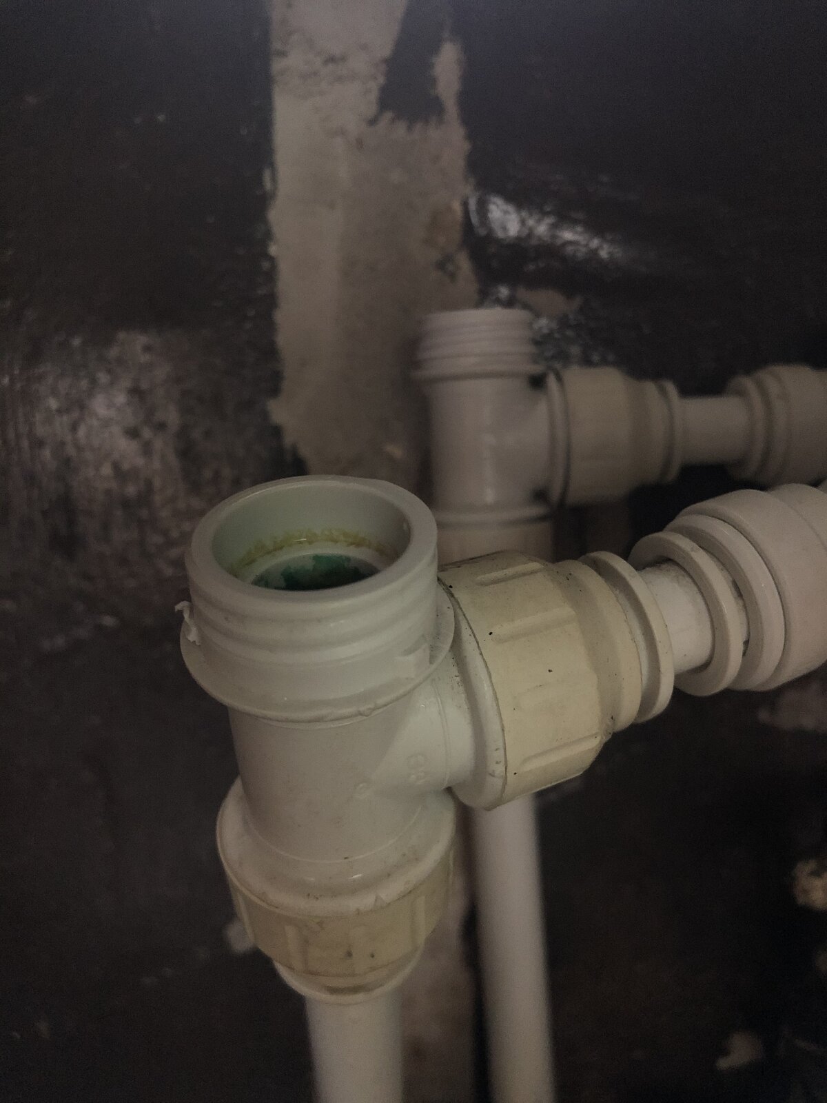

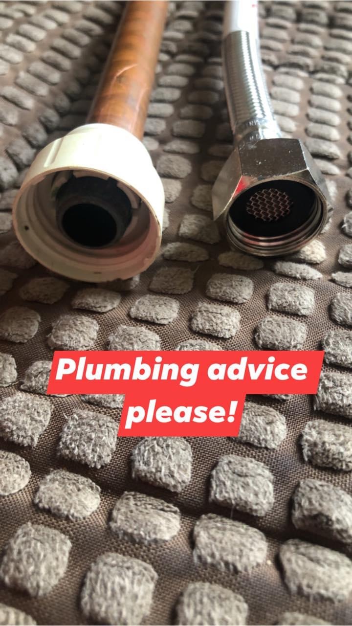

Help! New to this and just realised the supplied flexihoses on a new mixer tap don’t fit my wonky Looking plastic piping. Any idea what’s needed? I’ve been googling all day and still no clearer.
Old fitting is on the left in first pic which is a straight copper pipe. Any advice would be really massively appreciated!

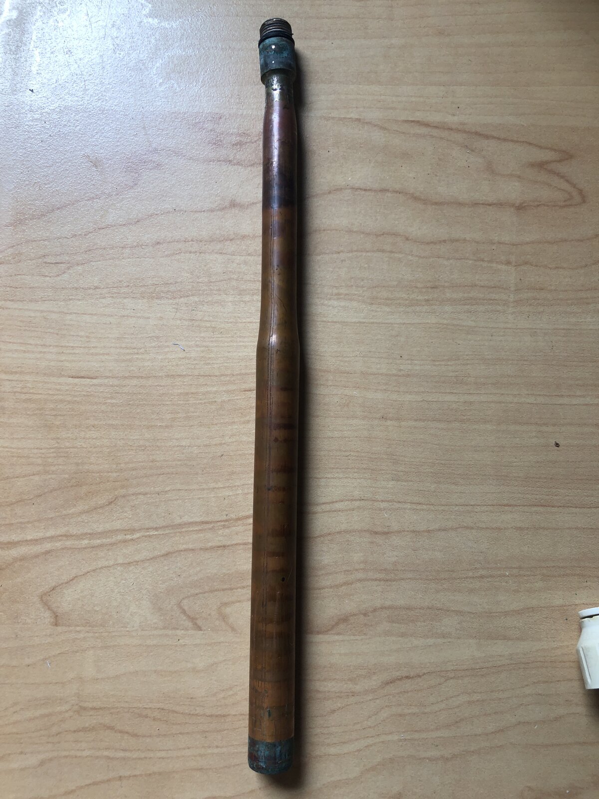

Would it maybe be easier for me to just buy new copper tap tails which would fit the new tap?
This is the copper tail from the previous pic

No I am afraid your going to have to cut the pipework, do you have a neighbour or local handyman with a pipe cutter ?

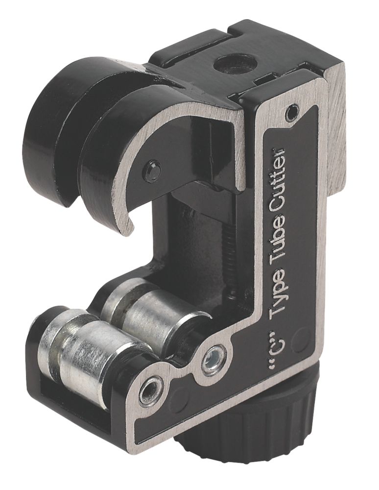

Pop to screwfix and get yourself on one of these:
https://www.screwfix.com/p/3-28mm-manual-multi-material-pipe-cutter/49428
ae235
All you do is put it over the pipe, turn the knob at the bottom until the wheel bites a bit, turn the cutter a few times, then then turn the knob a bit more and turn until the copper is cut.
Its easy, especially as the pipe is off and there is full access.
5 mins job done
