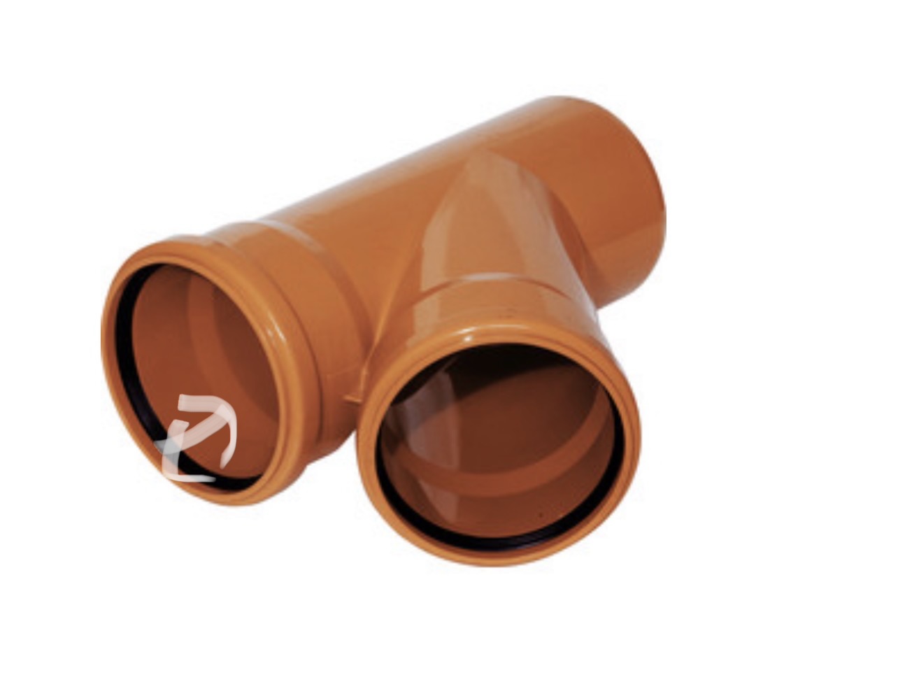

With this type of fitting, could I cut a section out of the sewer pipe, which is as long as the straight bit of this, then push one end on and use a slip coupling on the other end. If you follow my explanations, there will be a gap on this other end and I was wondering if the slip coupling can cope with that?

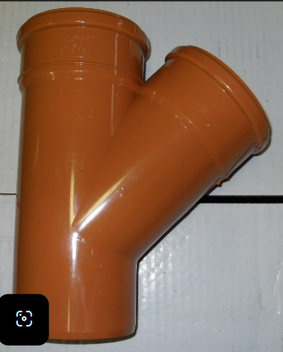

If need be, get a Triple socket Junction, and then put a short stub of Pipe in one end, then use your Slip Coupling. It'll give you some wriggle room to get the Junction into the existing line.
Junction https://www.bes.co.uk/triple-socket-equal-junction-110mm-x-45-13400/
Coupler https://www.bes.co.uk/110-mm-double-socket-coupler-pvc-with-removable-centre-stop-polypipe-13384/

Was doing some more reading on this and saw a suggestion that you use a triple socket junction and enter a small bit of pipe on both sides. You then cut the sewer pipe at this exact length, slip on couplings on both cut ends of the sewer pipe and this new junction (with the small lengths of pipe) can slot straight in. You then slide on the slip couplings.
Thoughts?
Why do you need 3 slip couplings? Cut a section out of the existing pipe, shove the tee onto the existing upstream pipe. Shove your new pipe into the new tee. The slip coupling is only needed between your tee and the downstream pipe.
You don’t need 3 slip couplings. 2 for my method.
With your approach, there will be a gap between the downstream sewer pipe and the small pipe length you have put into the downstream part of the tee, because the upstream has been pushed on to the sewer pipe?
No... You give yourself enough room to rotate the socket with a stub of pipe in one end, onto the existing cut pipe, when it's fully on you should have a tiny gap which the slip coupling then slides over and bridges.
If you wish to use 2 slips then that's up to you but unnecessary if you know what you're doing.
