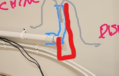

I built the utility area and it will be fitted out as part of the new kitchen upgrade. So it has the basic plumbing bits like hot cold and waste. I've attached a picture.
My plan is to add a vertical bit of 40mm (see blue bit) and then stick the two flexible grey pipes in the top (1x washing machine 1x dishwasher). I'll then add a T to the cold feed (no hot needed) to supply both units.

Sounds just fine. Try the two into 40mm, I think may fit with a squeeze, but if not, just fit a T, an elbow, and two downpipes.
Yes, but just form a trap with 3 bends and put the two hoses into a standpipe. That'll be fine for now.
