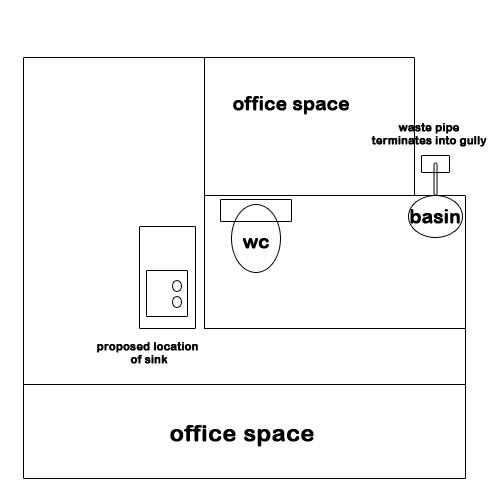

Hi,
I wonder if anyone can shed some light on this for me. A ground floor commercial premises requires a sink for tea and coffee making. The simplest and most cost effective method is to terminate the 40mm waste pipe into the WC pan connector. I have seen a pan connector with 40mm boss. Along with an antivac p trap is this acceptable plumbing practice? The alternative is to run 40mm waste pipe for several metres inside the premises. Is this the better option?
To give you an idea of the layout I have uploaded a VERY simple drawing.
Any advice would be greatly appreciated.

You can get bent pan connectors with a waste inlet on them, but I've only ever seen them in 32mm.
