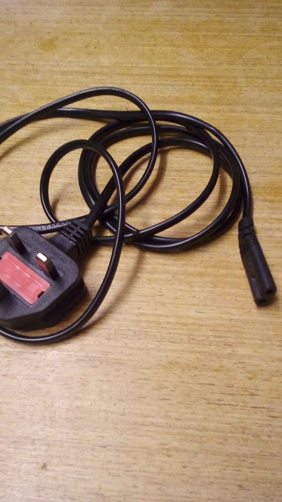

Never seen oval twin flex?

Not even something like this:
Anyway!
Luckily the oval twin flex is on another set of lower-rated lights, and the ones I'm extending are pretty much round cable so the connectors & heatshrink caps should be fine.
