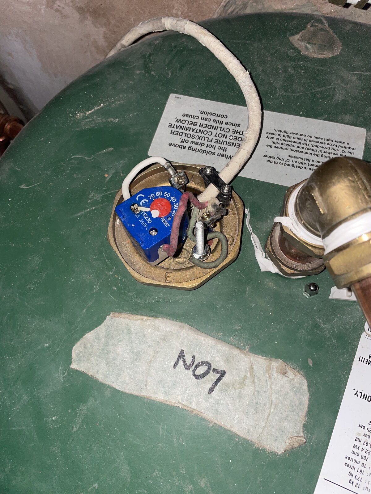

I have a new immersin heater in a cylinder
Facts
There is voltage and power going to the immersion heater
The reset button is down so not tripped
The red dial is at 70 degrees - If i turn the thermostat dial I do hear it click when it gets to 40 degrees
Questions
Does this indicate to you that the a) thermostat is working fine b) There is power to the immersion - I dont want to call out an electrican for £100 if I can at all avoid it but the water from hot tap is not hot enough and I suspect its the immersion which is not heating properly

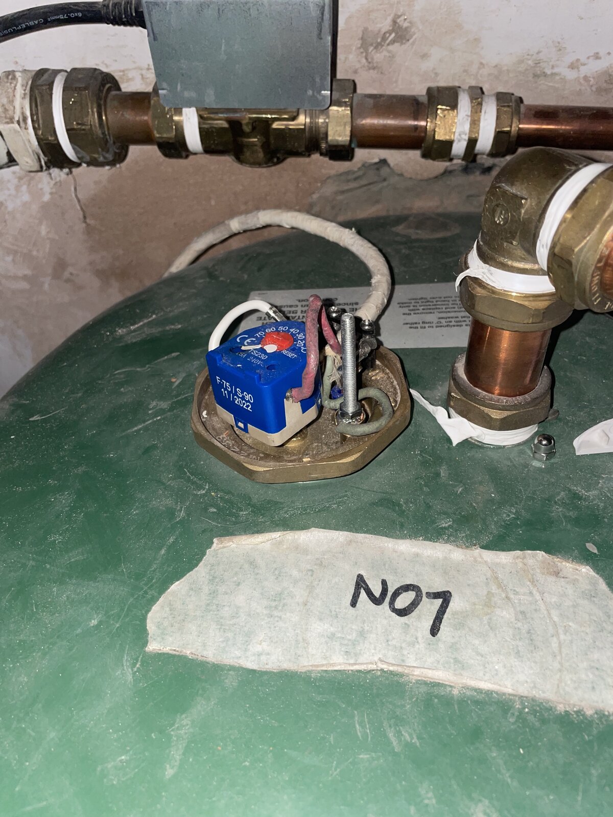

It also looks like the thermostat is not completely sitting in the pocket of the cylinder but I could be wrong here
I tried to take the top off and touched the blue plastic to adjust the red dial and had a mild electric shock so I am really scared now to even put it back together
Can these really not work fro the manufacturer ?
You really should turn the isolator off before removing (or replacing) the blue covers.
£100 for a simple call out sounds a lot (but is probably necessary) - do you live in central London?
It could be that the immersion has actually failed - a simple test on the heating element will be needed to determine this
  • Like
Reactions: CBW
Its in central london - after a few hours i still dont have very hot water even with boiler on - I think the immersion is knacered
If you are getting heated water ,but it's just not hot enough ,the element must be working . Why don't you use the boiler to heat the water in the cylinder ?
How have you checked for voltage?
I thin the water i sbeig heated from the boiler but its not hot enough - So I have to top it off with the immersion heater
So I did not test the resistance as I know I should have done but I did use a voltage pen which showed power at the thermostat when temp high enough
Ok ,so the water temperature you have in the cylinder has been heated by the boiler,so the immersion may not be working at all.
Volt pens do not detect the neutral is intact. You need to measure voltage with a multimeter ( which can be purchased for around 10 quid if you haven't got one),
measure live to neutral ,and live to earth.
