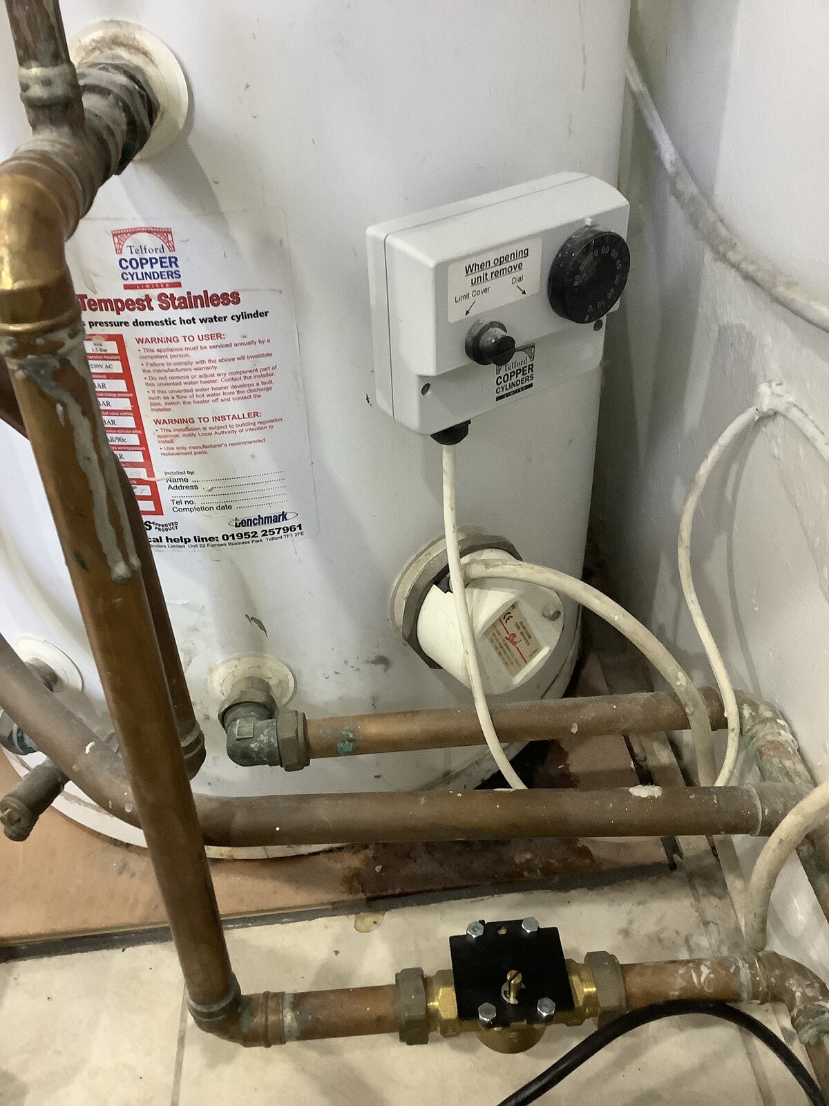

I’ve a problem with my mains pressure hot water tank not heating. I’m suspecting it’s the 2 port zone valve actuator (Siemens CZV222). Can anybody help me test this theory?
The system boiler works fine & any call for central heating fires it up.
The Water tank works when I switch on the aux heating element, it’s just that the boiler doesn’t fire up when I switch the water on at the controller. Normally we leave the water switched on all the time since the heat loss in the pressurised tank is so small.
If I switch on the water at the HW/CH controlle & slide the lever on the valve actuator from auto to manual, the boiler briefly fires up, but almost immediately goes off again. I’m assuming that there is some gubbins in the zone valve actuator that tells the HW/CH controller that it’s opened OK & maybe this is knackered? It’s either than or my controller is buggered. Any suggestions?

That is exactly how it works, the lever is a manual valve used for filling the system, it will not fire the boiler, have you checked the over heat thermostat on your HW cylinder ? if you are not sure where it is post a pic of it and someone will tell you how to test it, really simple 5 second job, if that hasnt tripped most likely the synchron motor inside the HW motorised valve unlesss you have been fitting new controls or something
It’s a tempest stainless from Telford Copper Cylinders.
Nothing new has been fitted.
It’s the motorised valve head that I think is gubbed. Here is a picture with the HW motorised valve head removed

It’s the motorised valve head that I think is gubbed. Here is a picture with the HW motorised valve head removed View attachment 294469
on the large white thermostat box there is a small black plastic cap, remove that its only finger tight, under there you will see a tiny pop up button press that and if it clicks then that has it been reset and that was the fault, if it doesnt then the motorised valve motor is the fault
PS you can not leave that set up running with the actuator removed like that
I’m off to get a replacement. There is 233V across those motorised wires when the HW is switched on. Seems like the motor is gubbed. When I slide the auto / man lever right over, that’s when the boiler kicks in. It stops if I let it come back a few mm into the locked position. I’m assuming that’s the micro switch you’re talking about. I see I can buy a replacement motor, but it seems a bit risky. I might buy one and fit it to this MV head & keep as a spare…I’ll post back if this all works. Thanks
That wasn’t the fault, but at least that’s checked. Mains is off to all this, I’m not leaving it like this for any length of time.

Technically just by removing the actuator head you have contravened regulations as you are noy G3 qualified so should not be touching it as it doubles as a safety device.
But if you are determined to change it buy one of these and simply cut the existing cable, and join the new actuator to the other end, and plug them together, that way you are not opening the wiring centre where if you get it wrong could be dangerous.
