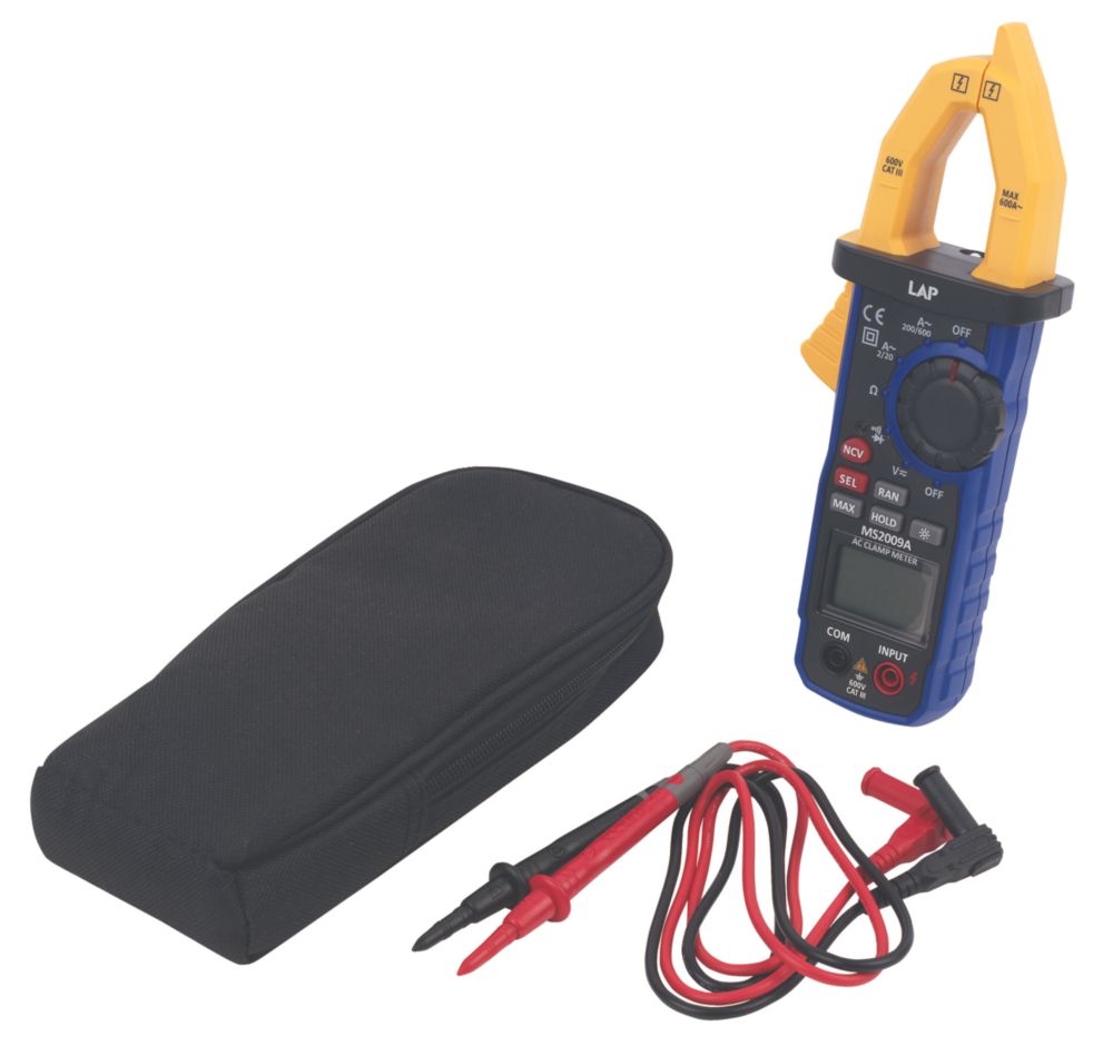

I would look for some where to safely clamp the meter on, I use some thing like this

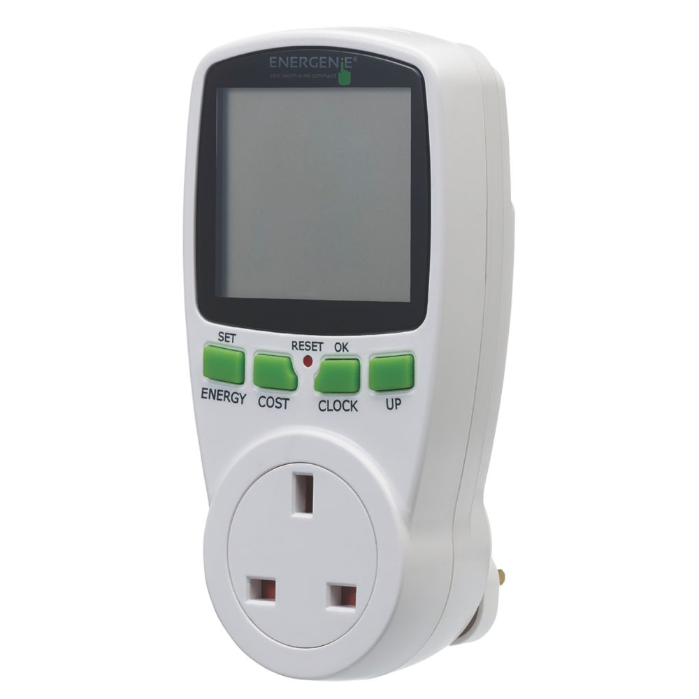

the other option if on a plug is something like this
using the amp range with a hard wired meter is not that easy, you have to wire it in series, it depends on access, some times you can lift one end of a fuse and put meter between fuse and fuse clip, but normally this is only good for extra low voltage as with low voltage (230 Vac) normally there is no access to the fuse.
Even with a meter like this

you need to still get access to the cables, and you can either measure the line or neutral but not both, so I had to make a short extension lead to get access to just the line, so if plugged in one of these
ae235
is easy safe way.
