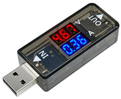

I use some thing like this
mine has two outputs but nearly the same, I have found in the main it is leads which cause the problems, I got some from Pound World and they only charge at 500 mA but same phone and same supply with different lead around 1.2 amp. Found Iphone seem to take full 2.2 amp, but nothing else on its own, I can plug in two Samsung phones and full 2.2 amp but one may get 1.8 amp but never seen full 2.2 amp.

Some USB power leads do not have the data conductors, just the two power conductors. The device then cannot handshake with the USB power unit to set up the charging rate the power unit can provide.
With my cheap Chinese 6Ah smartphone, it charges infinitely quicker with the supplied charger than any other.
It seems a resistance in the cables tells some thing what power it can take, and the first USB plugs took less than the latter ones, but to look at they look the same leads, and we could not work out why some times the phone had charged and some times failed, so I bought the meter, and marked up bad charging leads, for data transfer no problem, but charging current was low.
