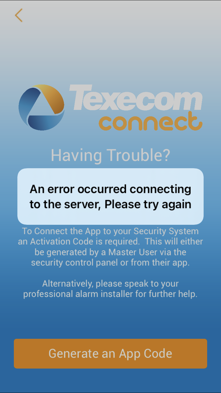

Hi,
I am trying to connect my Texecom Premier Elite alarm to the Texecom Connect app but keep getting a server error message following entering in the app code and Panay ID.
I’ve tried the smartcom both on wired and wi-if and it seems to be finding the panel ok as it is creating the app code. The code and user Panal number are definitely correct as I have changed the panel code and still getting the same issue. Any thoughts?

sounds like the issue could be the app end.
which version of the app, are you in the correct site.
on your device are you connected with mobile data or wifi.
if you power cycle your phone does it still come up the same.
The app version is 2.0.23
I've tried a few things and have gone back in to the panel this morning to generate the app code again and I am now getting 'No Carrier' when trying to generate the app code. The Smartcom appears to be connect to the wi-fi ok so not sure what this new issue means.
