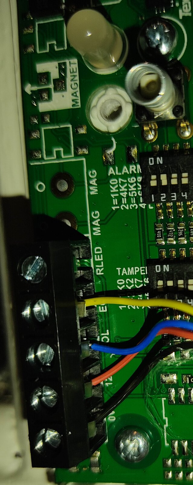

Hi, I have a Veritas R8 alarm panel and am trying to get a Texecom impaq s vibration detector to work, I have fitted a Texecom vibration detector to the shed door about 4 years ago with no problem (Different model to this one) power light is showing but i'm just getting a open circuit, looks like I might have to alter the dip switches but not sure where the tamper and alarm dips should be put, any help would be much appreciated.
Not sure if the pic is clear, dip on tamper and alarm are both switched to number 2. 1,3 and 4 switched to off, power is red and black, blue and yellow to EOL.

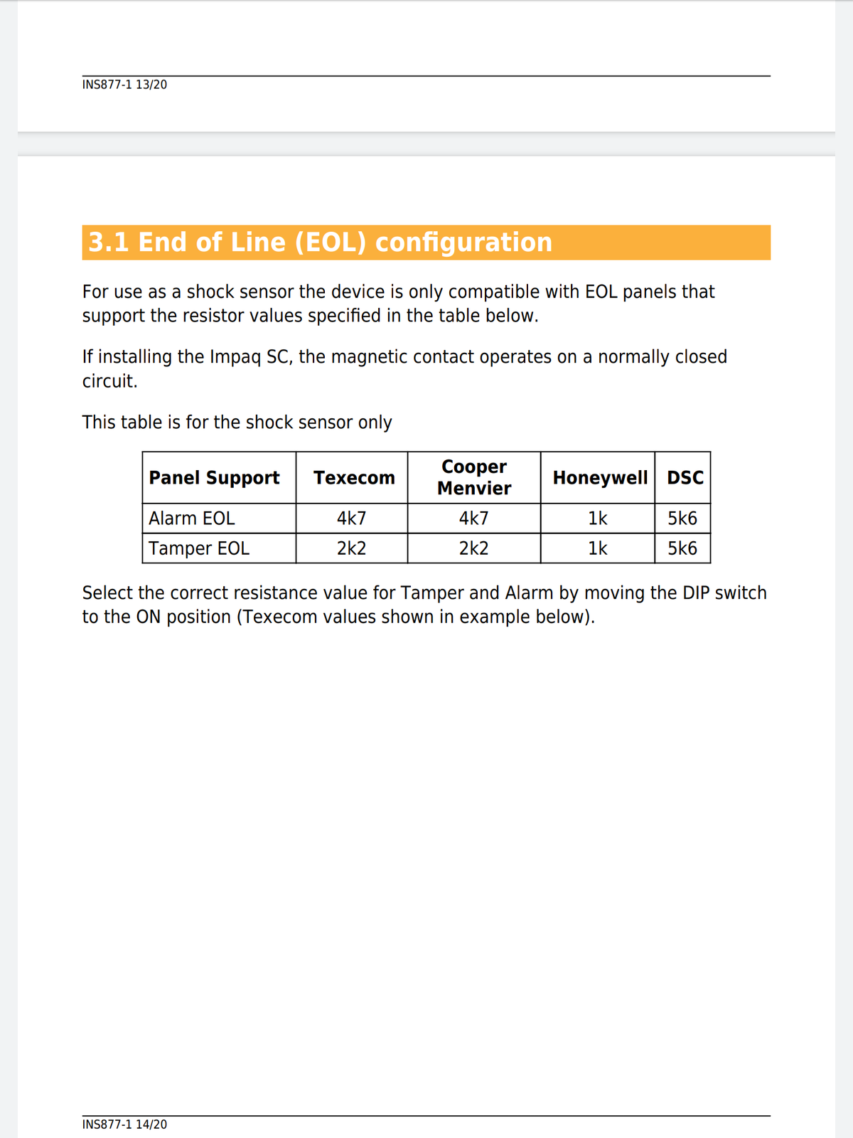

4k7 alarm, 2k2 tamper and program wiring type as double pole eol on a Texecom Premier/Premier Elite panel.
The shock sensor is only compatible with control panels that use EOL Wiring configuration.
The vertias 8R in not EOL
The newer R8+ can do these resistor values from memory think it was version 3.22 or something like that.
You probably need the Veritas Impaq E or the older Premier Impaq range which has been discontinued.
