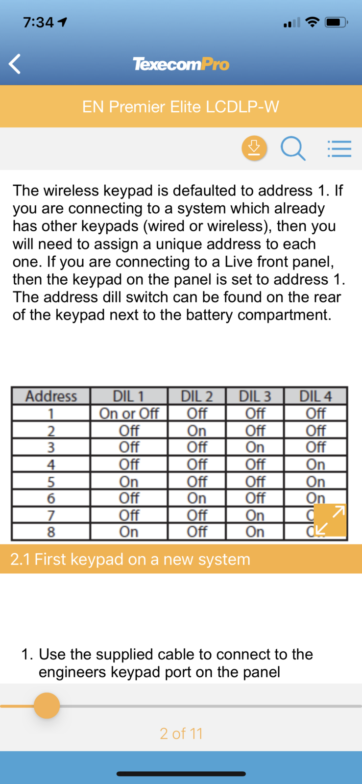

Hi all,
i Self installed my system in my previous house and it worked perfectly. I’ve moved house and got round to installing the alarm again.
I can get as far as connecting the wireless keypad to the engineers REM with commissioning mode on. Power on with defaults loaded. Silence alarm. I can get a PIR successfully added to zone 9 with ricochet, but when I remove the keypad from the panel to try and add it to a zone via ricochet, I never key a message to tell me the keypad has learned (even when I press the tick to learn the keypad). Within a couple of seconds, it just says “searching for ricochet network” and I can’t get it to move on from this point.
can anyone help???
check the dip switches are correctly set for the address of the unit.

Thank you. How would I know which one to use? It’s currently set to 1 (default). I haven’t changed it since the last install.
I tried learning the keypad before the PIR and that didn’t work. I guess learning the PIR proved the ricochet works. I must be doing something wrong with the keypad. You think it’s dip related?
a little confused, is this new equipment or reused equipment?
learning on the keypad with the correct address is relatively straight forward, however if the dip switches are an invalid keypad address they wont learn on.
also wont learn on if there is another keypad with the same address

I’ve only got one keypad. Just the wireless keypad. Dip is set to address 1.
i can’t get it to confirm it’s learned on. It seems to skip that part and get stuck looking for a ricochet network. Which it never finds!!
