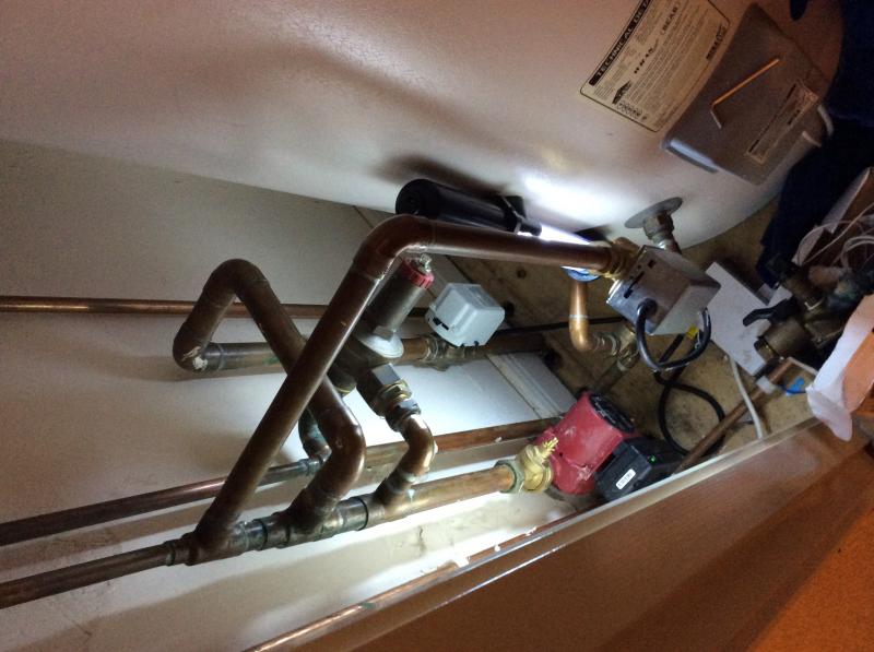

I have previously closed all of the other rads off, and yes the hot water spur was also closed.

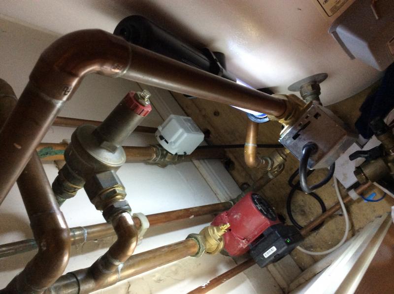

There is a bypass, as can be seen here:
Not sure on the brand of the boiler, will check later.
Hi, they loop behind the radiator and into the wall. Approx 10-15cm below where they go into the wall, the wall is warm so I presume they conenct to the rest of the system very close to where they go into the wall.
Well as they are before any zone valves, sounds like a bathroom rad.
Do any radiators still warm up when the hot water is only on?
