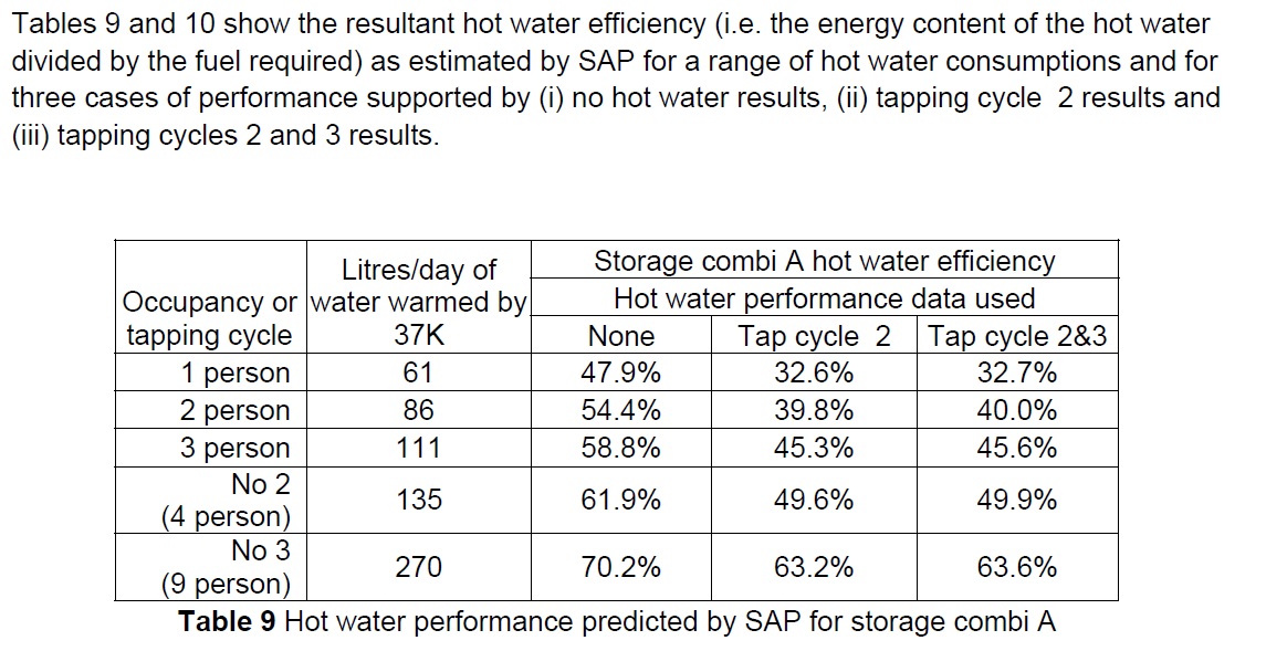

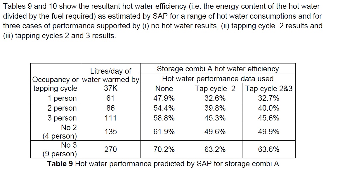

The efficiency when supplying hot water for washing up can be very low
Building Research Institute tests
Measurements of gas volume used and cold water run before hot water comes out of the boiler are being carried out by another research group. Early results suggest that over all efficiency is higher with a cylinder heated by a single but prolonged burn per day.
