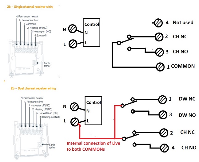

The "problem" is that the Single Channel Hive has one set of voltage free contacts but the Dual Channel has 2 sets of contacts with both Commons connected internally to the Live supply
your boiler has OT and 240v switching, make sure you connect to the 240v switching, use terminal 4 on the dual channel hive and L&N disconnect the other wires, no need to configure anything in the hive just remove the HW wires

As Chris has pointed out the connection are to the R-BUS which is ELV and NOT 230 volts The dual channel Hive will have put 230 volts onto the R-BUS terminals and quite likely this has damaged the boiler's PCB ( the reason the fuse blew twice )
