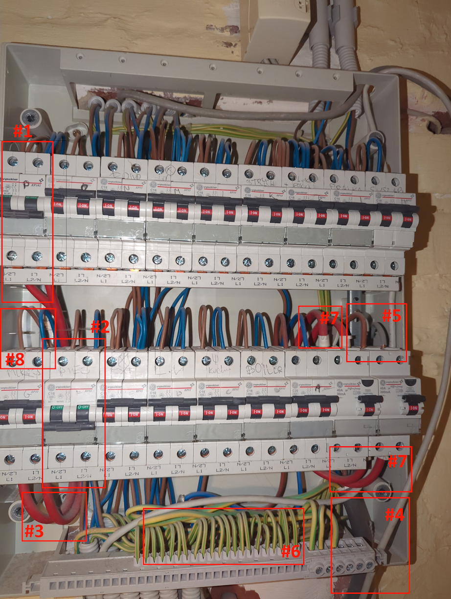

Hello dear viewer!
I come to this part of the forum to hopefully get some advice or basic knowledge.
In all honesty I have pretty much not a clue about anything at this point, but obviously need to start somewhere with doing home improvements.
I am very doubt full I will do things on my own, but without any knowledge it is rather difficult to even remotely asses who you should hire or approach a problem. I also realized recently I have quite the blind spot when it comes to handy stuff and need to fix that at least a little bit.
I am uploading pictures of the fuse box for you guys to have a general look and I am hoping for some feedback, advice, information in regards to (and anything else, cause honesty I do not even know what I should ask):
The current issues are the following:
Some parts of the house the electricity doesnt work any more (well duhh, some of the fuses are turned off) - Bathroom (ground floor) has light but the contacts where our heater was connected to is not working any more and the other contacts in the bathroom neither - Kids have no light in their room, contacts in their room work though.
The fuses as seen in the picture, which are turned off right now can not be turned on. They either directly popp out again, or lead to a take out of all other fuses as well (I think, but maybe its just the main fuses - is it relevant information?)
a.) Anything on first sight looking weird?
b.)
#4 The grey cable seems to be where the electricity is coming in. and ends up going from top inside the first fuse (see #5)
#5 Is that the main electricity coming in? Those cable look thin as heck?
#7 The big red cables "move" electricity from the bottom first fuse to the top part of the second fuse? Why are there seemingly two same fuses next to each other? Is there a functionality reason for it?
#6 What are those cables? Is it like a grounding thing or something? What exactly does that even mean? :D
#3 So we got some serious red cables again! But it seems a bit weird, that it seems that the electricity comes in from the top (#8) and goes out on the bottom? So really thin cables to really thick cables? That seems weird.
#1 and #2 are the fuses who keep being knocked out and I can not put them back into "on". Is it possible that the "fuse" is broken and simply needs replacing (I remember from 35 years ago when we had those old school fuses which needed to have a part replaced, when they blew)?
Also what is the yellow looking box thing above the fuse box?
Do I assume correctly that the electricity flows somewhere behind the fuses? Meaning it goes through the fuse to either blue/brown, and then circles back into the fuse through brown/blue?
Ah, and the red cables are connected to the big boy conductor on the bottom to the big boy conductor on the top? And the two fuses in the beginning #7 safeguards the incoming electricity and then guards the electro-city going to the conductor in the back of the bottom row?
Like I said I have no clue - please share knowledge, ask question, feedback or whatever. I am super green and for any progress on knowledge very ... its appreciated :) and I am excited on the progress already made, haha
-P
Additionally I got already the information that the two fuses on the bottom right are called RCD and protect life/fire, and additionally that maybe I should check the fuse functionality by disconnecting the cables (after off switching at least one RCD) and seeing if the fuse itself stays in upright.
Lastly I also only realized on being asked about it, that the fuse issues did not occur on at the same time, and I should investigate the issue separately (they got mixed up in my head).
(thanks @Ragnar_AT)
So some progress already happening :D
Anybody else any further input on this matter maybe? :)
The cause of that is probably not in this box; it will be “downstream” in the cables etc. that this supplies
I think this has been answered already.
Yes those are the earth (ground) wires. No I’m not going to explain all that from first principles…
It’s fine.
Unlikely.
The thing we can only see a tiny part of? Maybe something related to telephone or internet pr doorbell or similar.
Blimey. OK, so looking at most of the “fuses” (circuit breakers, MCBs), they are supplied from the bottom via the bus bars. The current goes from the L bus bar, through the L side of the breaker, to the brown wire; then to the lights / sockets / appliances, then back on the blue wire and through the N side of the breaker to the N bus bar.
