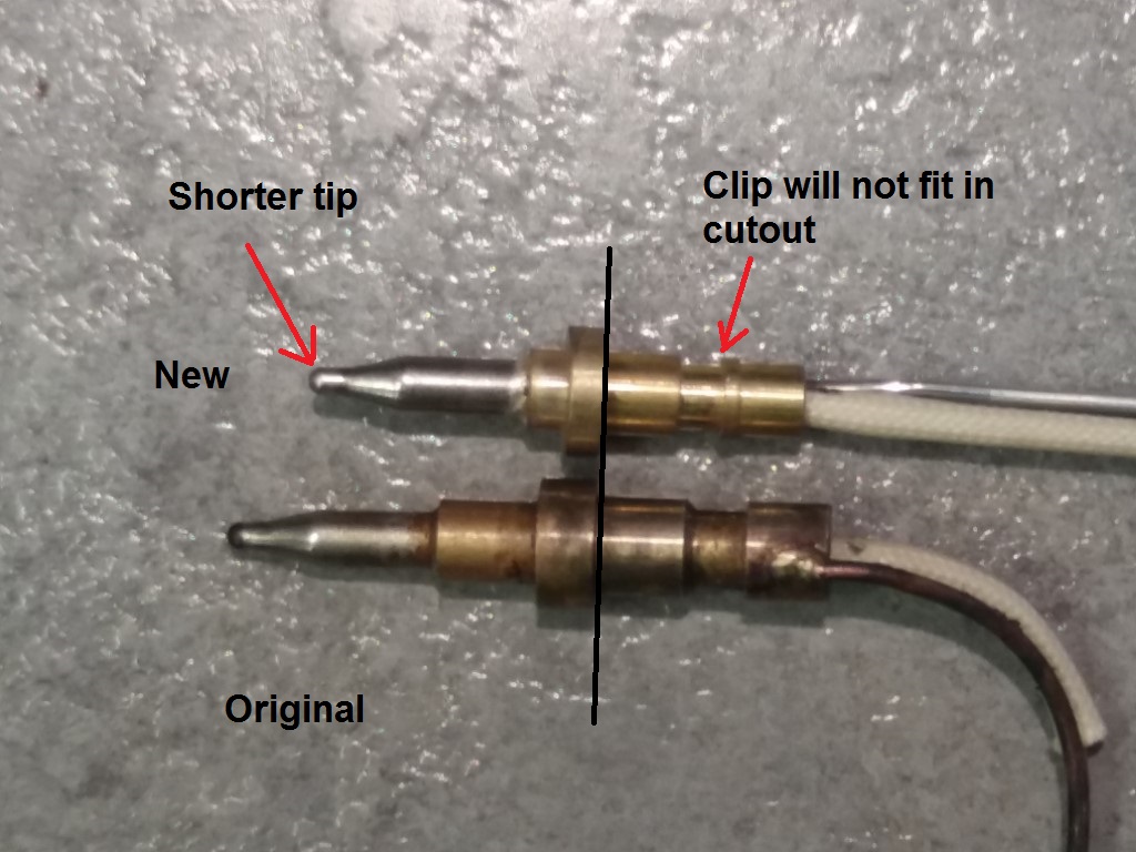

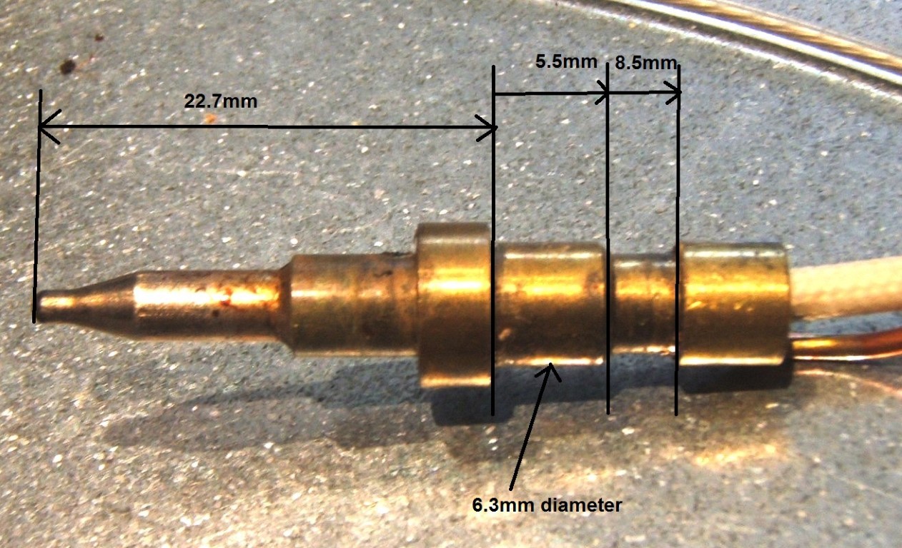

How does a thermocouple work? Does it produce an small electrical signal? Do they wear out.
I have an Ikea / Westinghouse hob; over the years, the thermocouples have been causing trouble to the extent that recently, some of the burners will not stay on. I have cleaned the head and the tc contact areas. This initially helps but within days, the problem starts again.
I have investigated replacing the tc, but the only one I bought, which was marked as correct for my hob, would not fit as it seems every hob manufacturer has a different fitting.
Grateful for any suggests as it is ridiculous to have to replace the entire hob.

Ignoring the detail that perhaps I want to become a Darwin Award contender, if I am unable to find a suitable tc, how would a certified gas engineer find one? There seems to be a million to choose from and they all have different fitting sizes.
Would be grateful for an answer to my question please.
If you mean ^^^^^ this question then see below
Being a gas engineer myself, 1st port of call is to obtain the GC number of the appliance and go from there. Failing this, contacting the manufacturer’s technical helpline/customer services.
