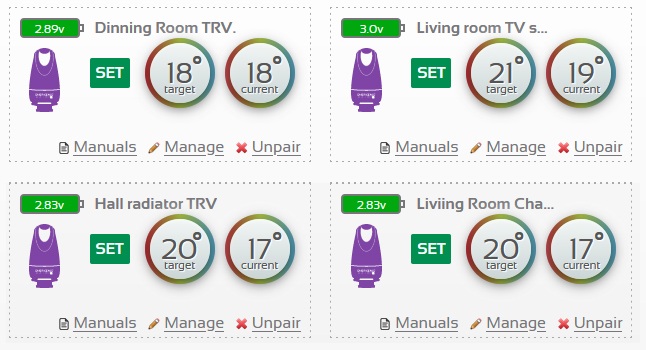

Mother house was first where we had a problem, mainly due to bay windows heating living room too fast, so was the first house where we used Energenie TRV heads, the main advantage was easy to set the lock shield valves, 4 TRVs-1.jpg they show target and current, clearly current should not exceed target, so if it did the lock shield closed a bit, new owners did not want them, so put old mechanical back, and once the lock shields were set, the old mechanical worked A1, however how do you know what temperature the TRV is set at when it just says *123456 ? needed TRV in degrees C to set lock shield in first place.
