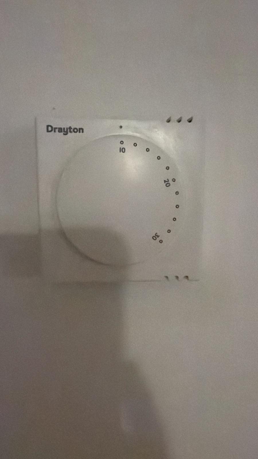

Is this likely to be 240v, does not seem to turn heating off, is there a test I can do to see if stat is faulty?
I think that is a volt free stat which means it just switches whichever voltage is supplied to it by a boiler or programmer but it might have a mains voltage supplied to it to make it operate. Carefully take it off the wall and see if it has 4 wires going into the back of it.
You can test it with a multi meter by checking that you have continuity across the contact terminals which make and break as you turn the knob.
Drayton, make a range of thermostats. Unfortunately for you they all look very similar from the front.

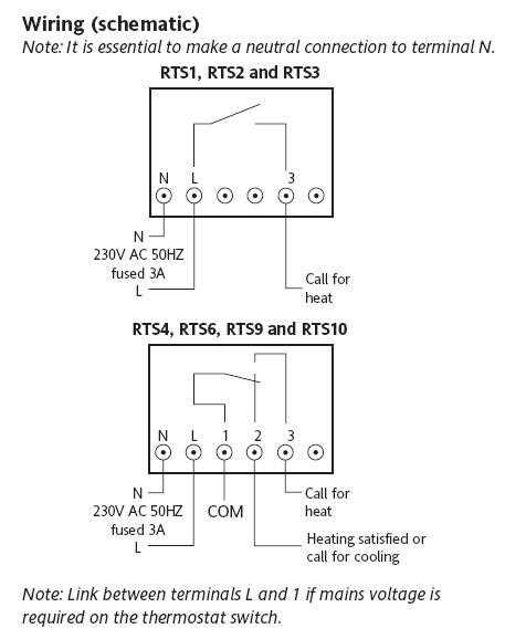

From the diagram below; If it's a RTS1,2 or 3 it will be 230V only. The RTS4, 6, 9 or 10 needs a 230V supply but the control side can be 230V or volt free.
With models RTS1, 2 or 3 - linking terminals L and 3 together would by-pass the thermostat and put the heating on.
With models RTS4, 6, 9 or 10 - linking terminals 1 and 3 would by-pass the thermostat and put the heating on.
