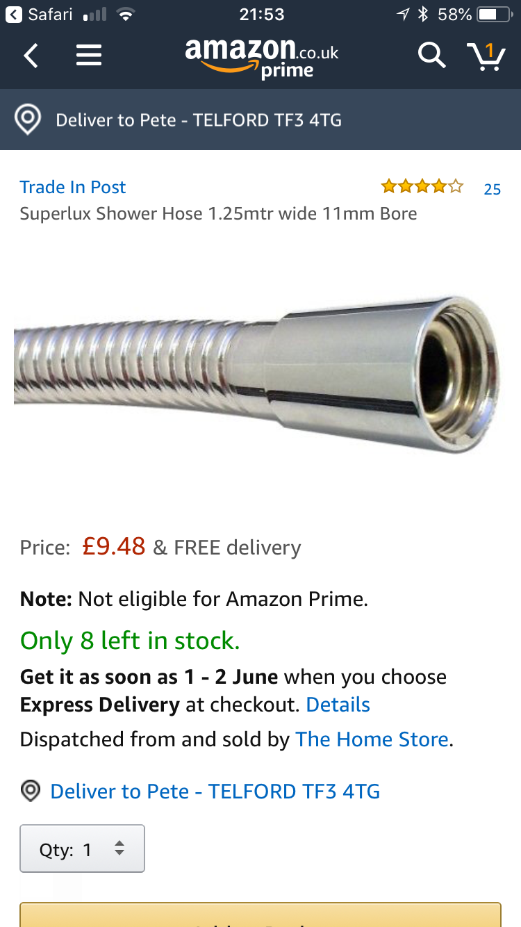

Wow - I took the shower hose off and filled a bucket directly from the wall shower outlet - got over 7l/m. How can a shower hose reduce the flow from 7 to 2, it seems crazy. It is one of the `clean easy` hoses, smooth all over and feels like plastic, I wonder if it has a really small internal bore or something. Know anything about them?
well you have identified the problem, new shower hose time also might be a good idea to get a new shower head too.
Glad to have helped mate... leave a review on google... lol
In all seriousness - some of the bores are tiny on those hoses and not really fit for purpose. I’ve seen them drop down to about 4mm.
Grab a new hose and you’ll soon be showering like the rest of modern society
Yes thanks for the help … hopefully my nightmare is coming to an end. Everyone in the house has been timing different parts of their showers with when the hot water comes through … only issue will be teenage kid with a full working shower ...… will cost much more to run :) Honestly I would leave a Google review or any other for that matter, but you'd need to let the technophobe know how to do it lol.
I'll update on the result … away looking for high flow hoses and shower heads now!
Something like this i reckon...
But hey, enjoy.

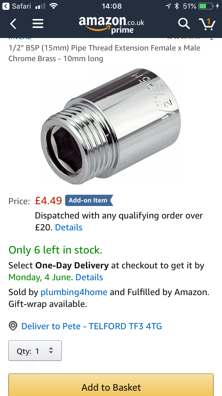

Well I fitted a 12mm bore hose tonight and its giving me 5 l/m now which is a big increase on 2! Water staying hot all the time …. happy chappy. Only issue is that the hose cone does not fit fully into the holding bracket so its a bit dodgy for falling out, but rather the risk of a sore toe than a cold shower :)
As combicert says - some hoses have small bores from new - others large when new, can partially collapse inside and of course, not be visible outside. Similar strange things have happened to (classic ) car flexible brake pipes, causing brakes to stay on.
You can get a little extension thingymajigger... (if you wanted to...)
Give me a min
Something like this sort of thing...
If you were so inclined... may work better.
