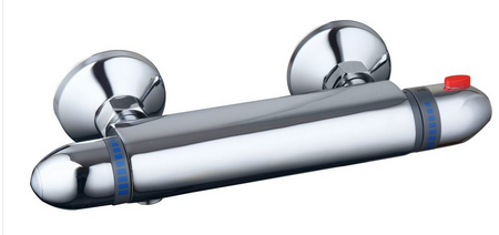

When I turn it on ...nothing no flow. If I leave turned on after maybe 5 minutes it starts to flow slowly then goes to full power but the temperature sometimes fluctuates. Once turned off I can turn it on say an hour later and it flows ok, however if left off overnight I have the same `no flow` again in the morning.
Any ideas what is likely to be wrong (image is similar to mine)
Fed from a combi the hot water would be under mains pressure,as would the cold,so the valve itself is faulty.
Those horizontal bar mixers are relatively inexpensive and easy to replace. I would just fit a new one.
OK, to replace do I just need to turn water off at the mains to replace it or is there likely another `turn off` at the combi boiler for the hot water.
Just turn off the water from the stopcock and switch off boiler from mains before replacing.
