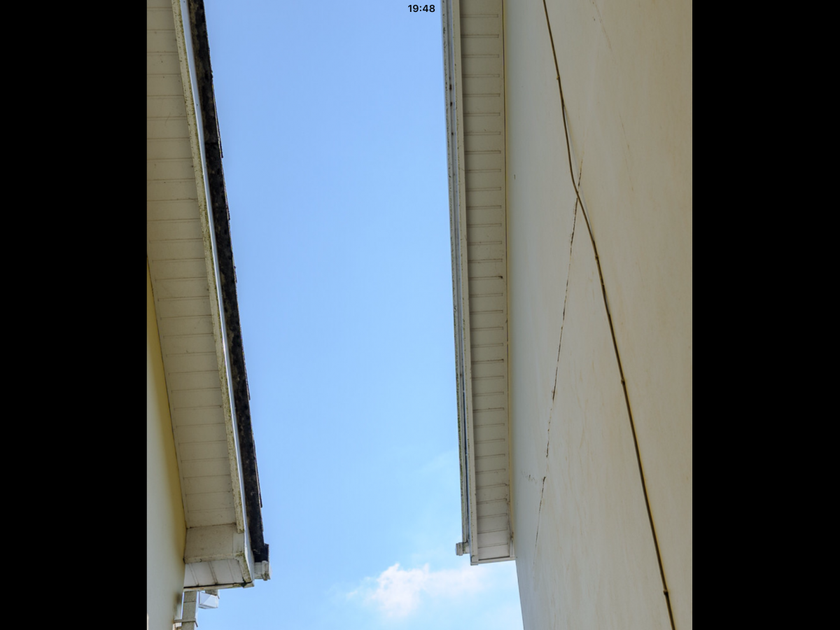

Our house has a thin crack in rendering - see photo. Our neighbouring houses have similar and one neighbour, who is a builder and who has lived in house for over 20 years, says to just fill as tend to reappear. Had a couple of plasterer out - one says he'd rake out either side, bond and then fill/skim; the other says would use newish tape which is flexible and then skim. Not sure what to do. Any advice?

Get a few better pictures up as we cant see much detail on that one...
That side of the house has a narrow pathway next it, so am taking photo from front. I'll try later when sun further around back. It isn't a wide crack but as that side of house gets very little sun, it seems to have a brown substance on it. We just don't know which way to go when given different options.
As above, definitely need new photos.
What material is the render - the builder neighbour should know?
Is there external insulation below the render?
Just a thought: Horizontal cracks like yours are sometimes the result of the rusting and expansion of the wall ties in the same bed.

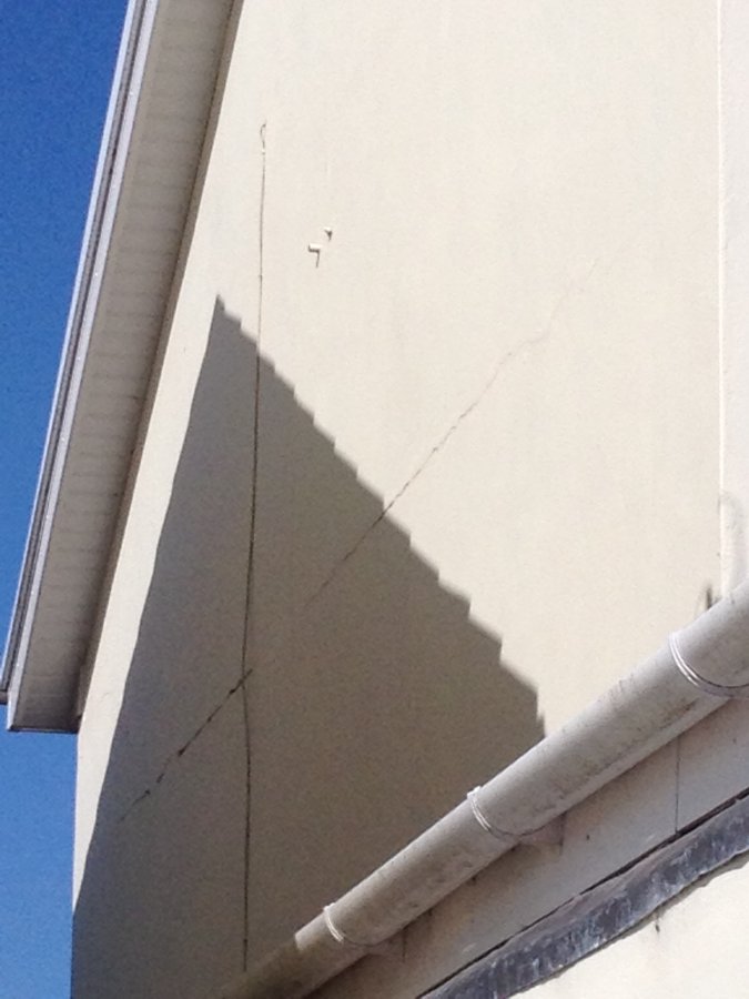

This is the best photo I can get due to the closeness of next door. Hopefully it gives more info.

No, the image takes me no further. However, it does show what looks like a vertical crack on the RH side of the horizontal crack.
I cant advise you further but perhaps do as the neighbouring builder says about filling with a sealant eg. an acrylic sealant is paintable.
