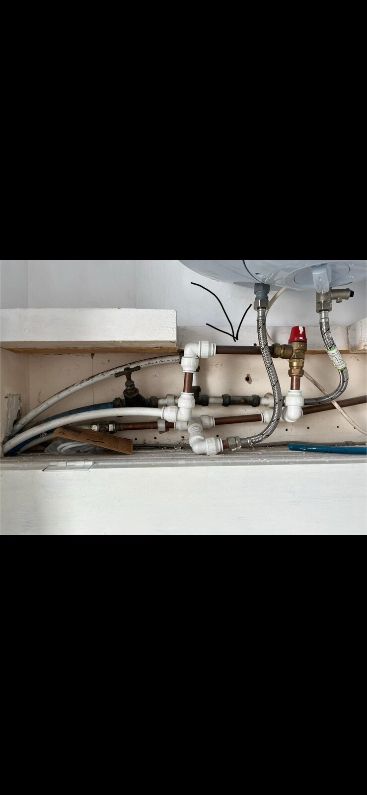

I have an electric water heater which is knocking near the pressure release valve.
It's leaking from somewhere under the bath which I guess may be where the pressure release valve releases to I'm not sure.
Does anyone know what would cause that please?

You probably need someone that is experienced with instantaneous heaters/unvented systems. If it's knocking then it could possibly be the pressure relief valve (PRV) that's opening but it's should be a direct connection to a plastic pipe like that. Does it knock regularly?
Hi it doesn't knock regularly, only been doing it when it's leaking
It's still dripping when the heaters turned off which makes me think it's a faulty PRV
I suggest to you it's the sound of the relief valve doing what it is meant to do - (saving the system from bursting through hydraulic overpressure). It's probable the pressure is rising too much as the water is being heated with no-where to expand to. Has the expansion vessel bladder lost all the air?

Thanks, if it lost it's air would that explain water still dripping from the PRV even when the water in the heater has cooled a bit
Obviously it's been very hot recently which probably has a bearing on it?
Is it an instantaneous water heater? 15/30L? Make/Model?
The banging is the PRV doing it's job, the pressure climbs, the PRV lifts, the pressure drops and the valve slams back down. I'd be more concerned as to why it's opening. As suggested that install doesn't seem correct and it really should be looked at by someone that understands unvented systems. or vessel sized dependent, another look at the MI and that install sorted to how it should be.

Looks like it's 8 Litree currently
Depends - I wouldn't suggest that your current vessel isn't large enough, though your unvented system and as part of that the expansion vessel probably needs serviced.
