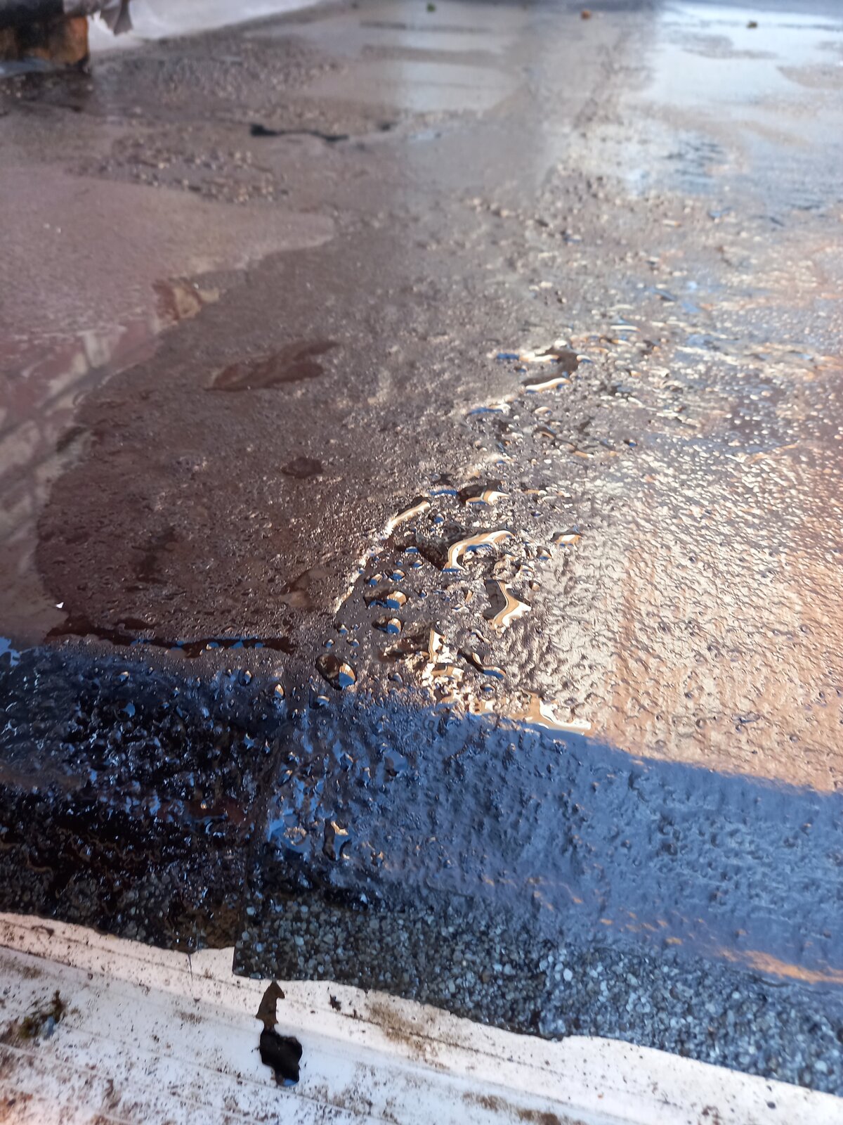

How long should a 'thicker than 1mm' coat of Thomsons one-coat take to dry, before being safe for rain?
I applied according to the instructions; "can be applied to moist surfaces" and "is rain-proof immediately".
However, what I didn't appreciate was; "ponded water should not be allowed to stand on newly applied roof seal".
I applied the stuff. Rain 'maybe' in about 6 hours. Came back the next day and the whole lot had lifted, like a skin on custurd. When prodded, it was full of water underneath and of course, not adhered. The only option was to scrape it all off and start again.
I think that I hadn't realised quite how uneven the roof was.

If I'm reading the same product data sheet online it says 24h to dry.
Start early as you can.
If rain is likely cover up if not dry...

Not read the online data sheet, I will look at this. I was just going off what was on the side of the tin.
I think the problem is, that I'm laying it on thicker than the 1mm. Also, covering it up isn't possible unless I can make it totally water-tight. It's a 'very' flat roof and puddles everywhere. I don't think 24hrs will be enough. I'm thinking 48hrs min without forecast rain and hopefully, won't be scraping the whole lot off again, again.
It sold says don't apply over silicone based roofs.
What was the original roof?
Oooo. Good point, not noticed that.
It was previously coated in Thompsons 10 year roof seal. I'd put a couple of coats on a couple of years back but they'd started to blister.
I did however have a a couple of areas where I'd tried to resolve the suspected leaking at board edges, by using an all-weather silicone sealant. I'd pulled most of it off. Thinking about it, maybe this is what and where the issue is.
I'll have closer look at this.
Thank you for your observation and suggestion.

I've just re-visited the property and had a prod at the product. It's been some 5 days since I applied it originally and 3 days since I scraped the excess / non-stuck stuff off. It is still tacky. I would have thought that it would have gone off by now. We haven't had that cold weather. I'm beginning to think I may have had a dodgy tin of the stuff.... :(
