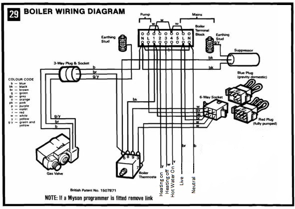

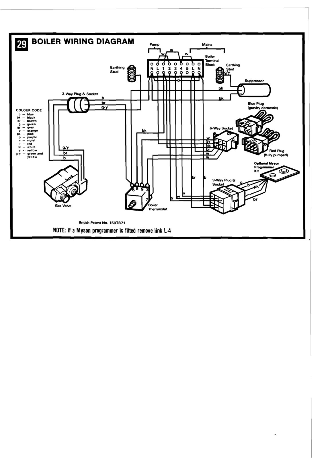

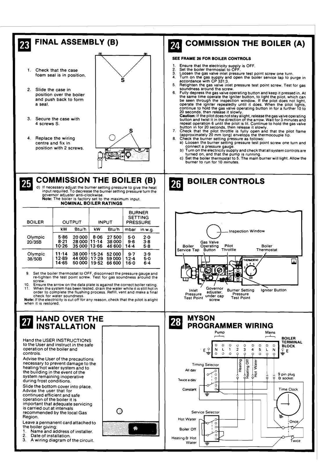

Hi Again
I found the following wiring diagram for the boiler, I was going to use the existing connector block to hook everything up as per the bottom right diagram - number 28
I'll discover more when I open the boiler up, but this has three wires hooked up as well as live and neutral.
I'd be grateful if you wouldn't mind commenting on this. I'm guessing it's because the RWB2001 has independent hot water and central heating switches which the original doesn't

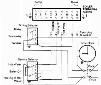

I have to confess that I haven't worked on one of these as they are rather old, so can't offer any personal experience. However, if you take the programmer wiring as per your post...
...you can see that the programmer is connected to a L & N supply, and provides 3 control signals back in return:
Heating 'on' (connected to boiler terminal 2)
Heating 'off' (connected to boiler terminal 3)
Hot water 'on' (connected to boiler terminal 4)
As well as requiring a L & N, those same three control signals are available from the RWB
Heating 'on' (4)
Heating 'off' (2)
Hot water 'on' (3)
However, as you have gravity circulation of hot water and pumped central heating, you will not be able to have the central heating 'on' without the hot water being 'on' also. This is a restriction of the plumbing not the controls. I seem to remember that some RWB programmers have a selector switch at the back marked G (gravity) and P (Pumped) which would be set to G for your system. This makes sure the hot water is turned on automatically whenever the heating is selected on.
However if your programmer doesn't have this switch, you will have to make sure that the set 'heating on' times, correspond with the 'hot water on' times.

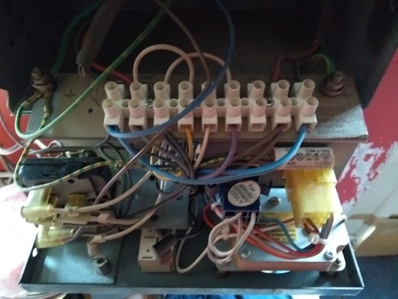

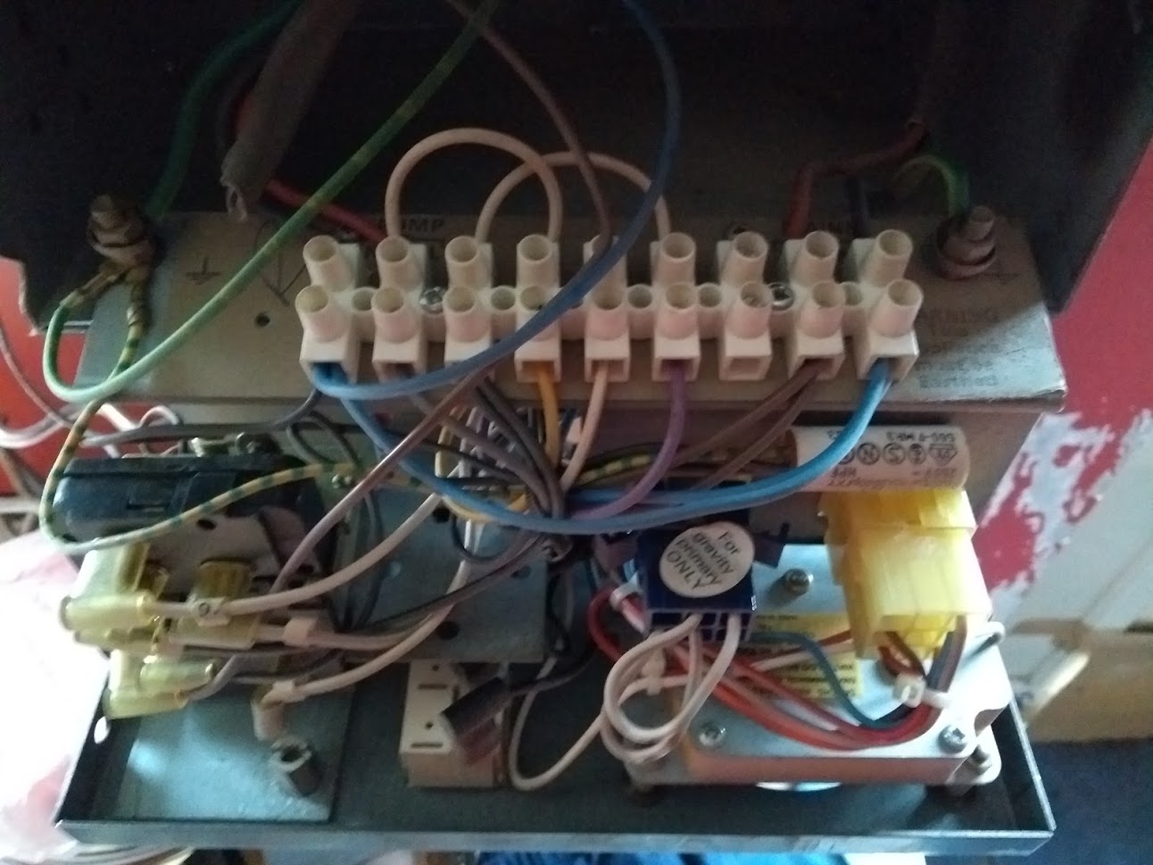

Managed to get a picture of the insides today - all as expected

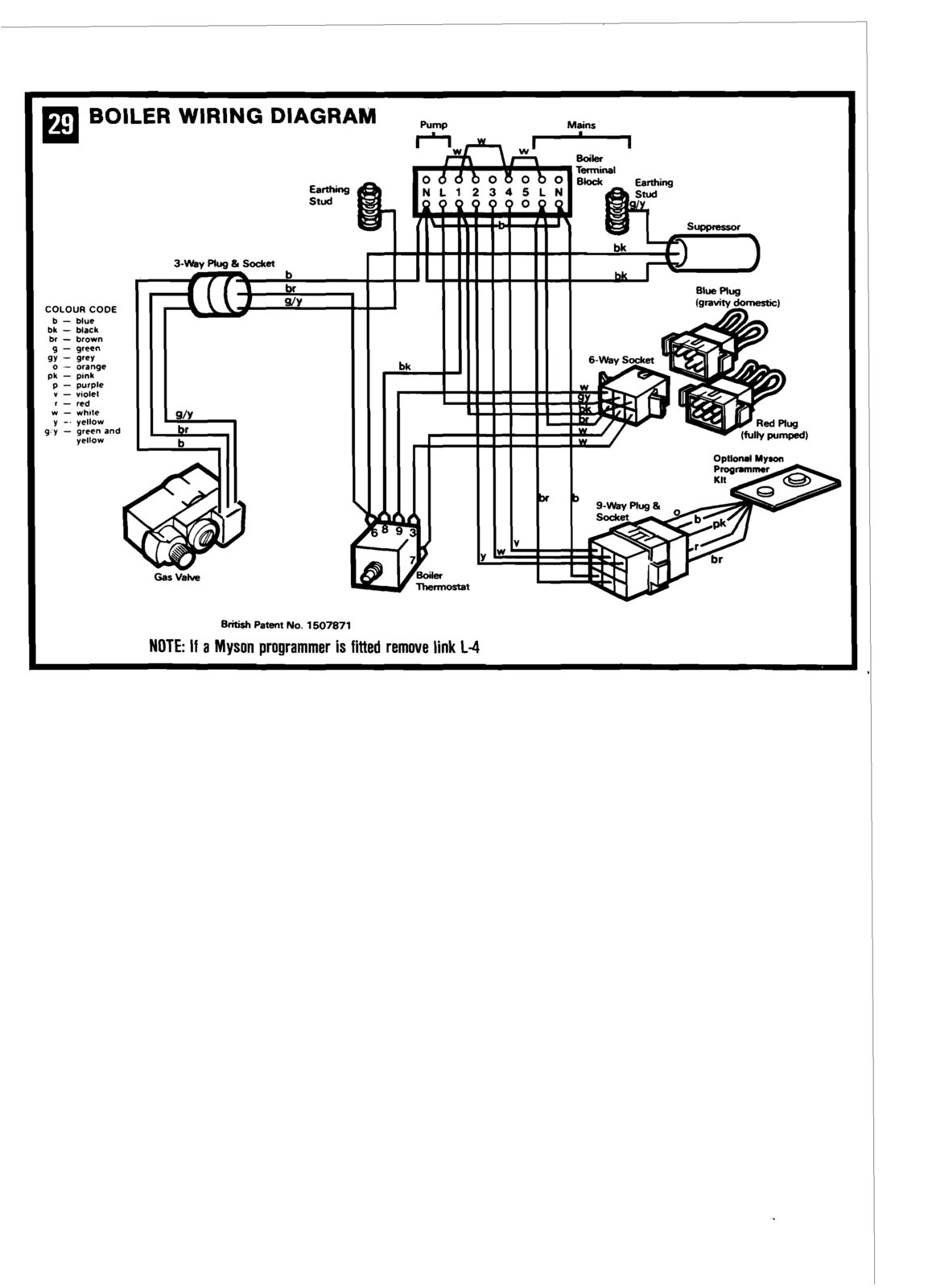

...and here we have a list of components that hook up to the main connector, so that we have a complete wiring picture from start to finish...
Just need to get some proper hook up cable, and give it all a whirl
