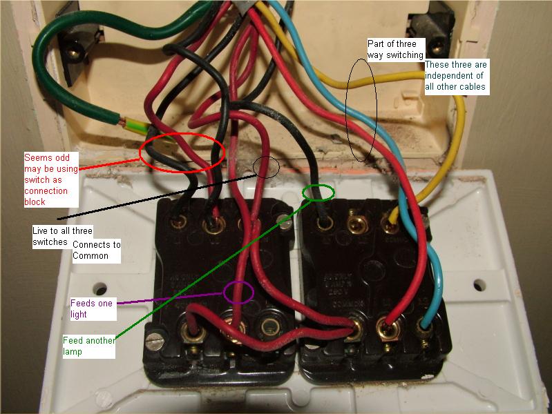

Crack your living room light switch open and get us a picture of what's in there. By the looks of it something was wired 2 way. That 4th switch obviously did something at some point. Are you certain that it didn't do anything at all.

Thanks for the replys guys, i will head off and get the 3 gang switch, Dunc i cant say if there was nothing on the forth at all at some point, we had a kitchen refit 10 years back and an external garage removed at the same time, i think there was even an outside light at some point., pic of the living room switch, first is living room ceiling lights, second wall lights, third is the porch lights and forth is the landing light

Looking at your picture the cables to right are clearly part of a two way switching arrangement and you must get the Yellow on common and it should be no problem.
Next you can see the three commons are feed by a single red wire. The two centre switches are wired one way i.e. Off / on and should be not problem.
The switch to left however does not seem to make sense. The switch will feed either the black wire or the black and red wire and without seeing which wires come from which cables hard to tell what they may do.
I wonder if the last switch on left is used as a connector block. However as shown all four switches do something and you said only three do anything.
All I can suggest is copy what is already there.
here I show how two switches are grouped. 1, 2 and 3 are one switch and 5, 6 and 7 are a separate switch each switch is inverted to other so 3 and 7 are common and it is important to get the wires in common correct. If you swap 1 and 2 or 5 and 6 the off will become on and on will become off but get 3 and 7 in wrong place and it will not work.

The picture you are showing is the front room switch where there isnt a problem, just a pic someone requested further up the thread, these two pics are the ones im talking about, 1st is how the original kitchen switch looked when wired up, second is the new switch i got today that needs the first pic wiring into...if you know what i mean? :oops: bare with me mate
