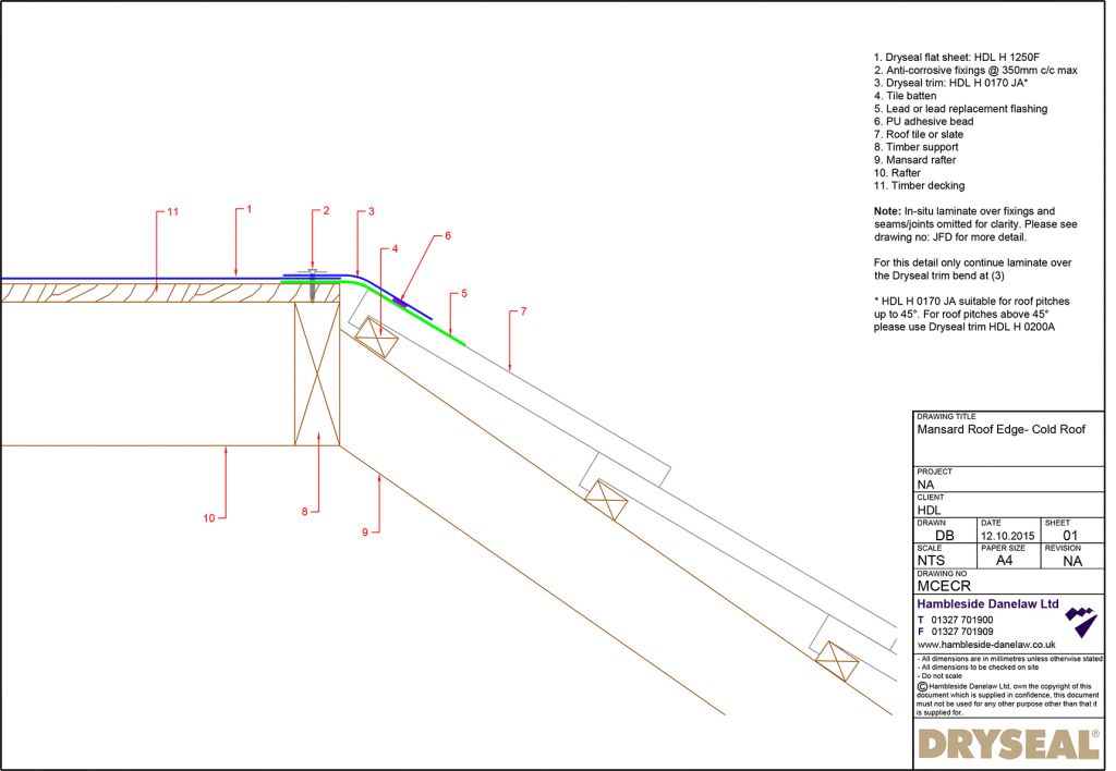

This is how GRP roof finishes onto tiles via some lead - is that OK?
Thanks I will discuss with roofer and see what he says. I am guessing the risk is the expansion of the lead forces the GRP to crack? Or hopefully the grp would just debond from lead below to form sliding surface.
Regarding the hip-irons I dont believe these are required for dry verge system - the bottom verge tiles will be the pre-formed ones with the angle already made - and will be double fixed.
I believe the detail below might suit my roof profile ? I will ask and it is probably something that can be more easily retrofitted now
