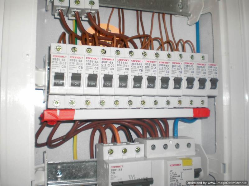

Building a new flat, and the power supply is 3 phase 3X25A.
My contractor changed the electrician half-way through the job. The previous electrician was going to wire all the phases together (to my understanding in effect simulating a 75A connection) The new guy is a bit of an #$@%, allocated the circuits to phases and refuses to explain how he allocated them (about 15 circuits) between phases, on the basis that he'll be available (at a fee I presume) to sort things out later.
Setting aside the attitude for a moment, I have usually handled home electrics myself - I am however familiar with older homes. In this case, in the consumer unit the allocation is carried out via an "allocation strip" (?) - I am unfamiliar with these.
I want to be able to reallocate circuits myself (if I suddenly find that the kettle, the washer and the dryer are placed on the same 25A phase, for example) - if anyone can point me to an information source on this this method of allocating circuits, I'd be glad. Have not managed to find anything myself... If this is not a common item, I'll post a pic.
D.
I'm not absolutely certain of the exact arrangement in your particular unit, but it sounds as though it's probably just a flexible busbar arrangement which allows the fitted MCB's to be split between the phases by rearranging the busbar links somehow. Are all the MCB's in one line? Some photos would certainly help.

Thanks for the replies.
Attached is a pic - after asking around a but more, I found out that (as MikeR said) it is indeed a bus bar which allocates circuits to phases on a consecutive basis.
I am not happy leaving this as is - firstly as it's my house I want to know what's connected to what OK, simple job using a radio plugged into each socket).
Secondly,remember, he didn't know which circuit is which - simply connected the wires left in the distrib board by his workers - and the chances of him getting it right by chance are not zero but pretty close. There is a substantial load if everything really does work together (~ 70 A or so, not all of it installed yet )and I want to plan this myself instead of having breakers tripped and then going back to figure out how it's put together.
It's a little difficult to see exactly how the supply busbars are arranged, whether in sequence A-B-C-A-B-C etc. or whether they're grouped together in some way, e.g. A-A-A-B-B-B-C-C-C etc.
Could you take another picture with the busbar cover removed? (The white trim which has red tape around the ends.)
