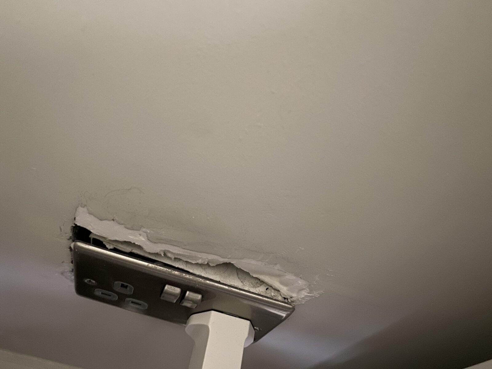

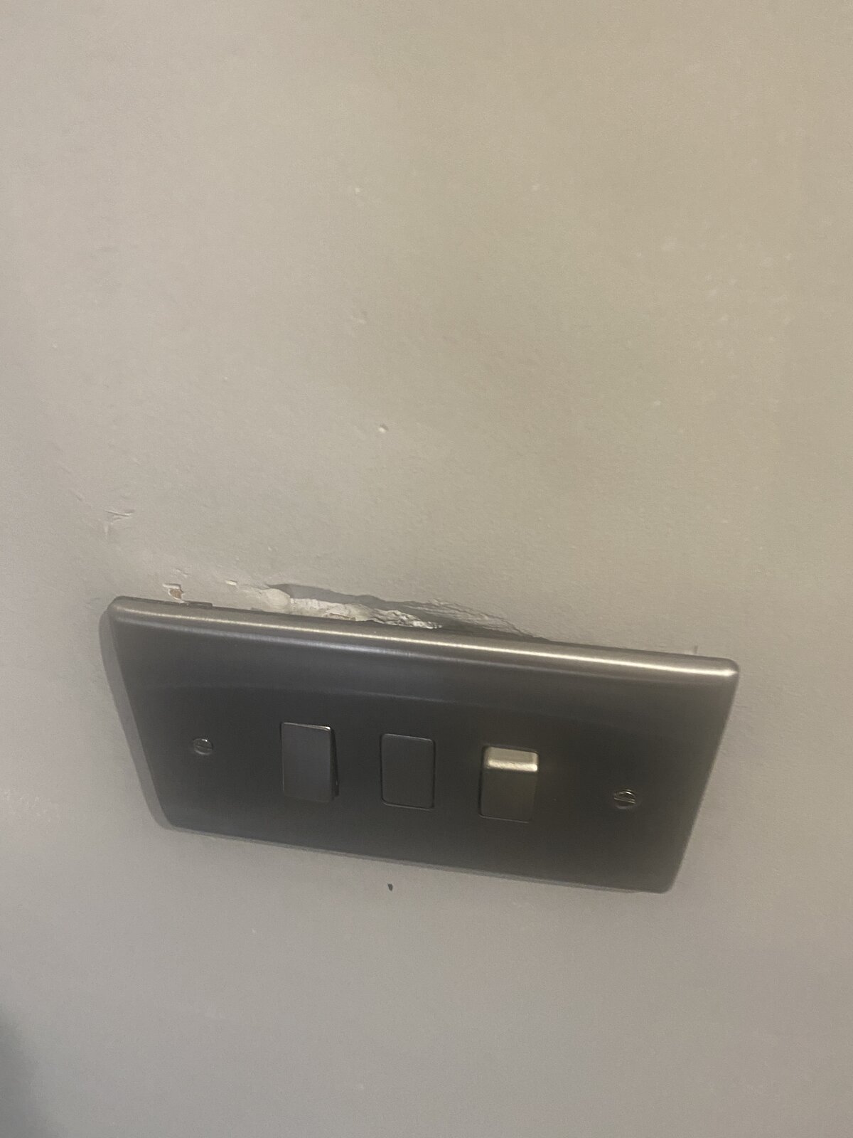

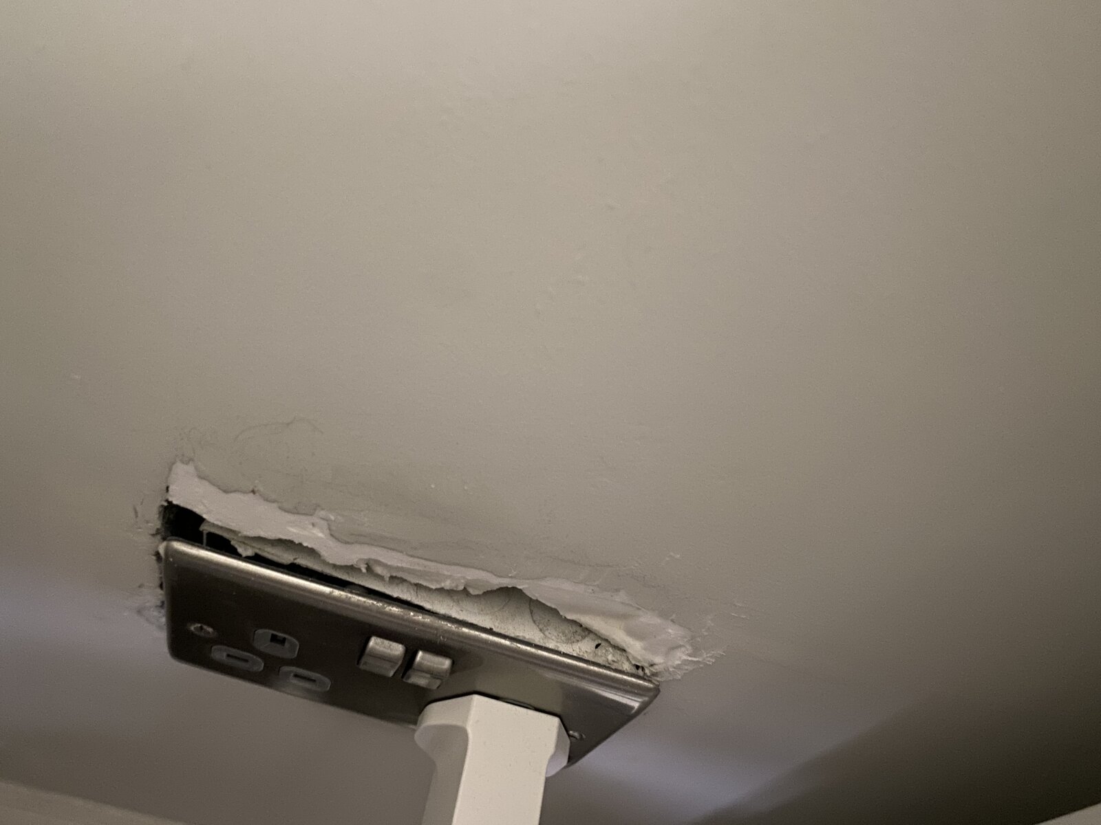

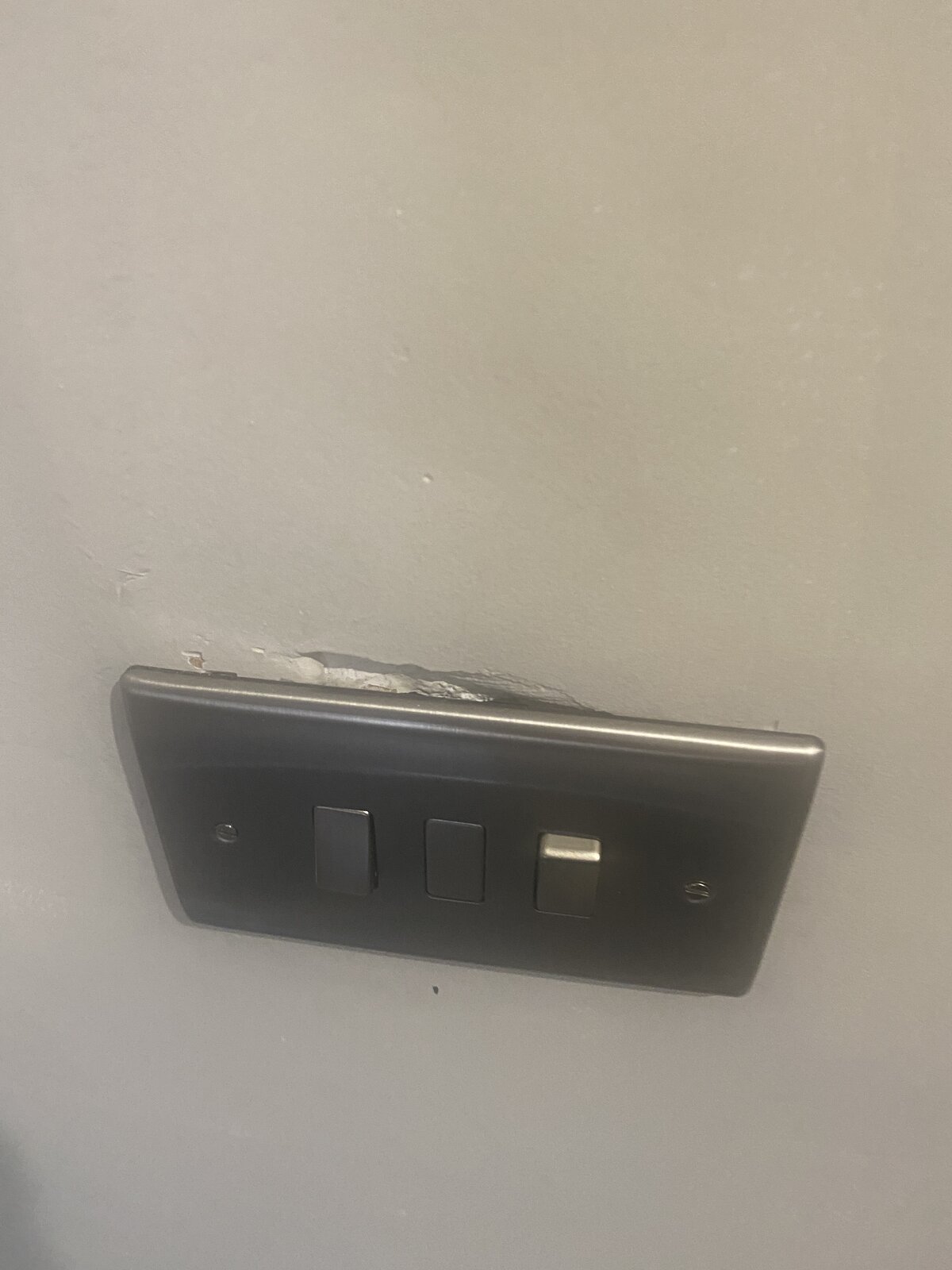

Hi there,
We had our house replastered and rewired throughout.
The builder who did the plastering did a pretty messy job generally (should have found a dedicated plasterer I know...) but particularly rough around the sockets/light switches. He has offered to come back and tidy with some filler but I'm not inclined to let him over the threshold.
I've bought some plastic 'sockitz' boxes to go around the sockets while I fill the gaps in, sand and paint - but any suggestions on the best filler to be using?
Attached a couple of photos for context (these are some of the better ones!).
Steve

Good grief!
Need to take sockets off.
Make wires safe..Use wago and tape.
Put straight edge across to check all is flat.
Those socket things are good although I've never used. Will need to chip plaster back first so they sit flush with wall.
Not sure how they are held on wall but I use polymer grab to stick beads ect on prior to skim.
Use toupret quick dry powder to make good.
Go watch CharlieDIY YouTube channel on fitting and filling sockets for interest.
Yours will be different but get tips on getting it done
