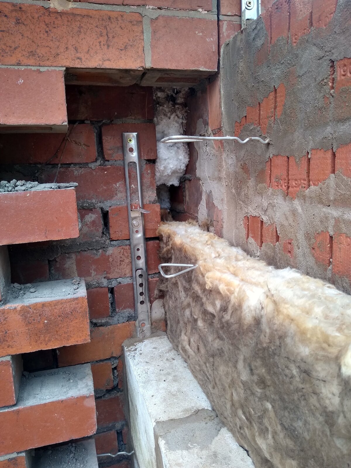

I cut through mine. 9" grinder, 3x 6mm drill holes all the way through the bricks so they split off neatly, pushed the batts as far as I could into the existing cavity.
