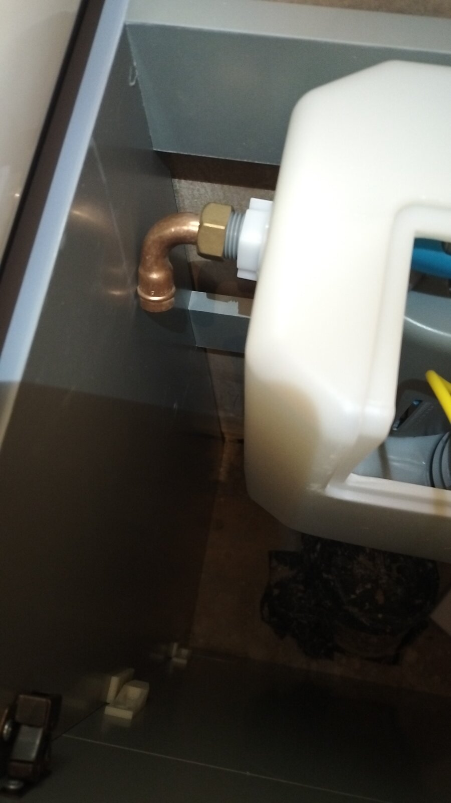

I have this concealed cistern 500mm it's tight too tight for a soldered bent tap connector are end feed ones tighter? Or any other ideas? Thanks
Can you adjust the nuts that secure the float valve to the cistern ,in order to take the float valve further into the cistern ,creating a few millimetres of space to accommodate the tap connector ?
Fit a spacer / plastic washers. Doesn't look like you need to gain more than a few millimetres for the tap connector to clear the cabinet ?
If that doesn't sort it ,fit a 90 degree female elbow ( such as Screwfix code 55471 )

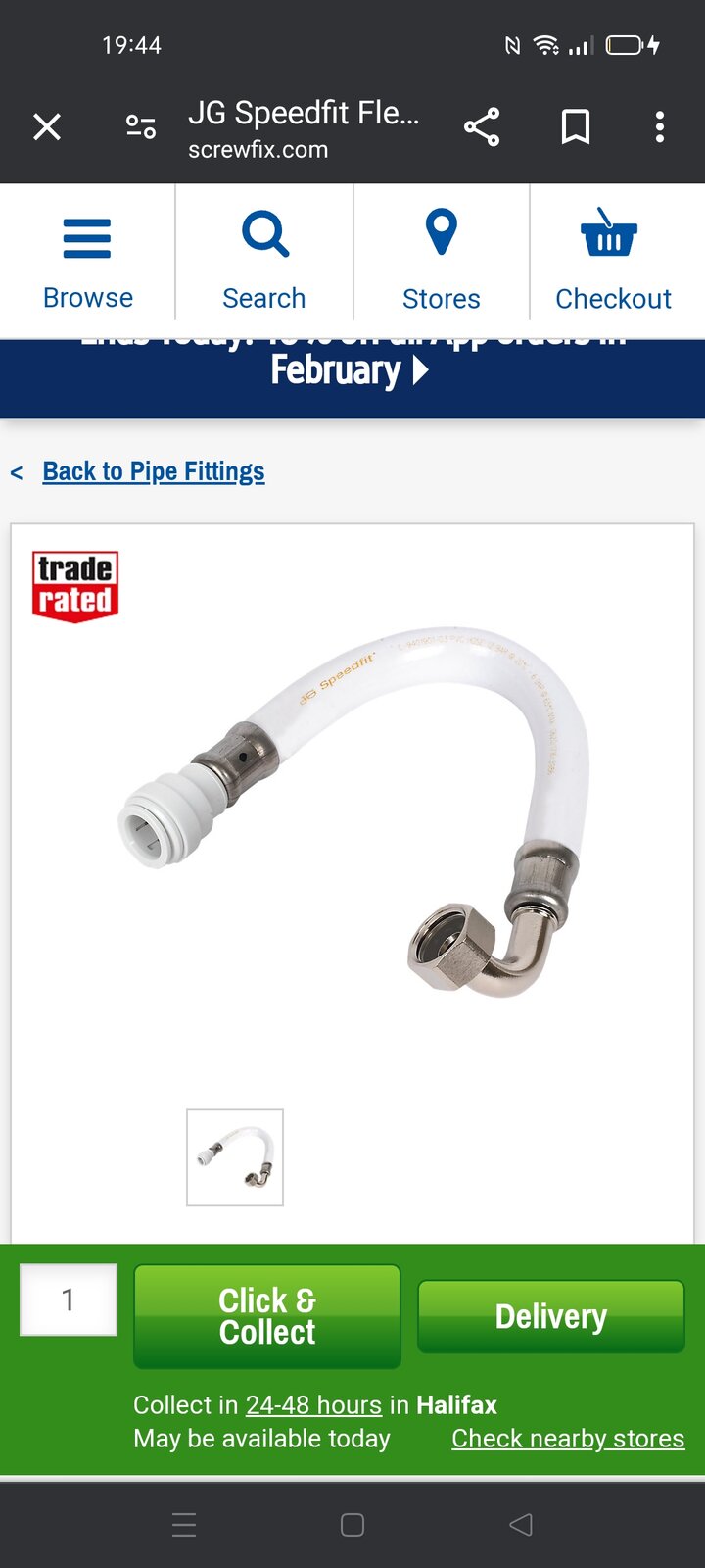

Thanks I was looking at these are this just a Flexi but with speedfit pipe?
I don’t think it uses Speedfit pipe as such, but it has a Speedfit connector (rather than a compression one, like I linked to above).
Have you tried a bent flexi on there? Might not need a spacer anymore.
