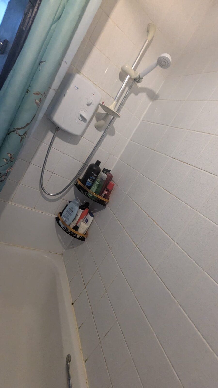

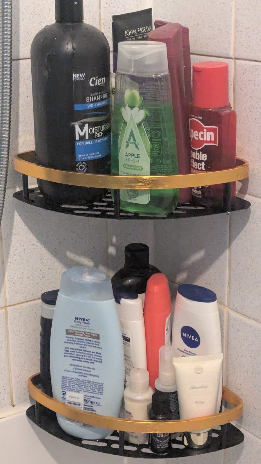

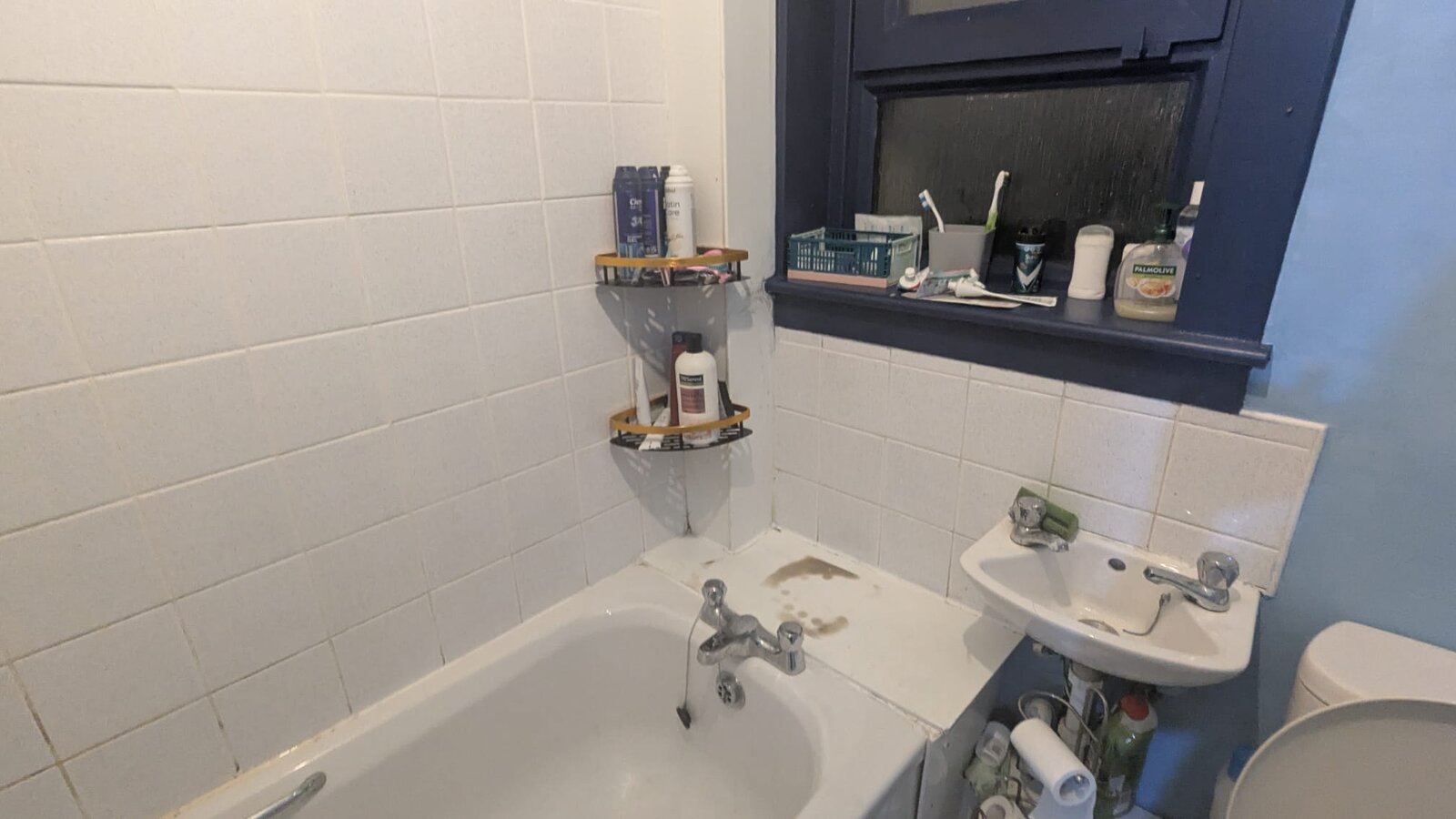

this worked well, thank you! The drilltip skittering around was a little bit of a pain, but i used light contact and a steady hand to abrade the surface until it could get a firm grip, and drilled two holes no problem
Well, there is a problem but its not related to the tiles
:p
an old fashioned hand drill
You mean like this?
I'm happy to report that the operation was a success and my new bathroom shelves are mounted and sturdy, thank you for the advice everyone
