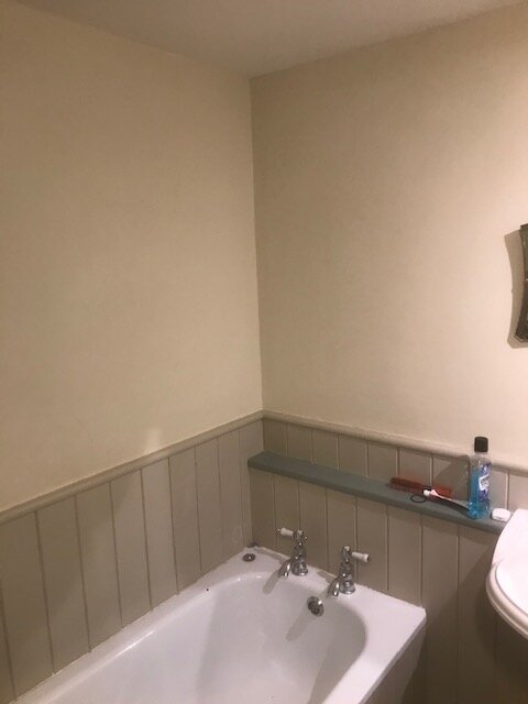

I am looking to install a shower in a bathroom where the previous owners only had a bath.
I was just going to swap out the taps for a mixer with shower hose, paint the wooden paneling with a glossy latex/enamel paint and tile from the border up to the ceiling. I will also box out a small return to attach the glass screen. Ps, I'll put a slight pitch on the shelf too.
My question is about tiling onto the wall. First time I've done a house of this age.
The cottage is 200yrs old, both walls of the corner are external, stone walls with (I assume) a lime based render.
Can I tile straight onto the wall as normal or will a liquid tanking layer stop the stone breathing etc? I was wondering if I needed to make a false wall with an air space to let the air move (I'm just imagining here) to stop damp getting trapped behind the tiles? Are there breathable tanking layers? Is it all about the correct adhesive? Etc etc etc?
Any help will be great.
Cheers, Mike
