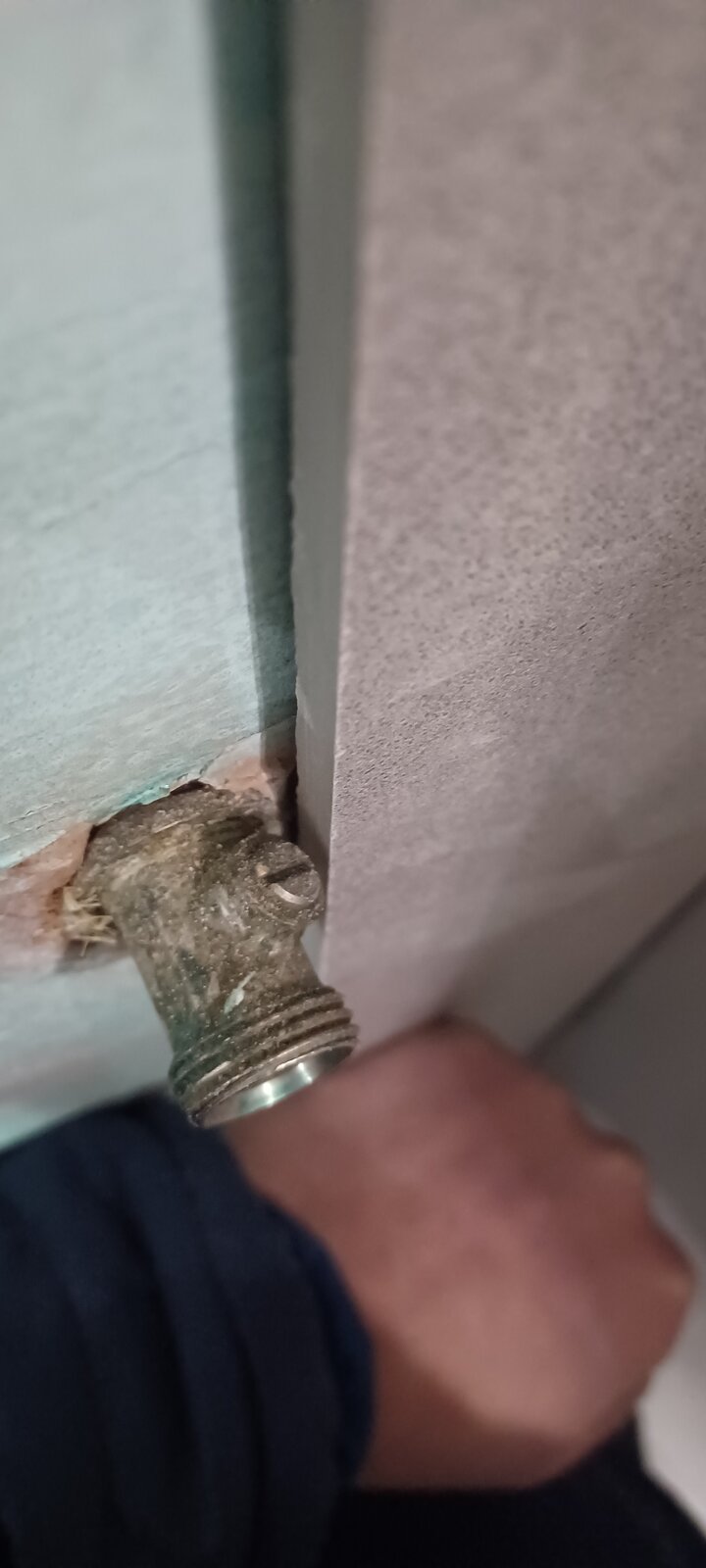

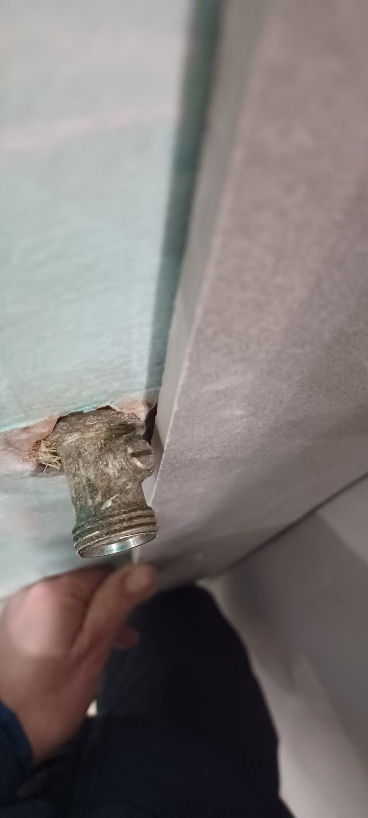

Hi all
Got an potential problem with how to tile a wall where there is a shower outlet point for connecting a hand held shower attachment. If you see the photos, the problem is evident. The tiles are 10mm depth (so 12mm allowing for adhesive), but it seems clear to me that this will obscure the thread for attaching the shower connector. Plus, the slotted screw which will need to be turned, in order to enable the flow to the shower attachment.
Not sure of the best way to approach this one, grateful for any advice.

That's an isolating valve, not a shower attachment. How much can you remove without making a complete mess to attach a suitable fitting should be the question.
Thanks. I've not tiled in this situation before, but I am assuming that the face of the tile should be BEHIND the isolation screw. In which case that would either mean taking it back to brick to get the depth required, or extending the valve outwards somehow?
You could leave that valve fully open and isolate the shower somewhere else earlier along the pipe.

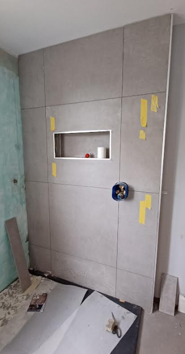

It is part of a back to brick renovation, so all the pipework is new. The shower control is a recessed thermostatic mixer valve (Grohe) which will feed a main shower head (to be dropped from ceiling), but has a diverter position to send flow to that valve in the wall. All the shower pipework is boxed into the studwork on the adjacent wall, which is now tiled over. In the photo below you can see that valve just to the left.
My guess is that it was put on for testing purposes and not removed. Can you get the fitting off? What you need is either a 1/2 BSP, male or female, or 15mm copper, at the correct depth, depending on which wall outlet you are using.
Oof, a shower wand hose will screw onto it so I suppose it could be the intent that it's just the outlet for the wand. It's a bit gash but might look better with a chrome surround, like what you might use to hide a rad pipe cut out in a floor
If it truly is intended to be the thing onto which the wand is screwed, then you'd need to set the screw to open and leave it that way; the diverter tap in the shower mixer block will determine if water flows to the wand, not this
I'd have expected whatever wand is intended to come with a fitting that's a bit more decorative than that iso though; if there truly isn't one then maybe at least turn the valve so the screw is at the bottom and less visible
Standard shower hose won’t fit that it too large , needs replacement the grohe shower should have come with required outlet, often sticks out thru tile with a plate to tidy it and a (grub screwed )outer connection.
