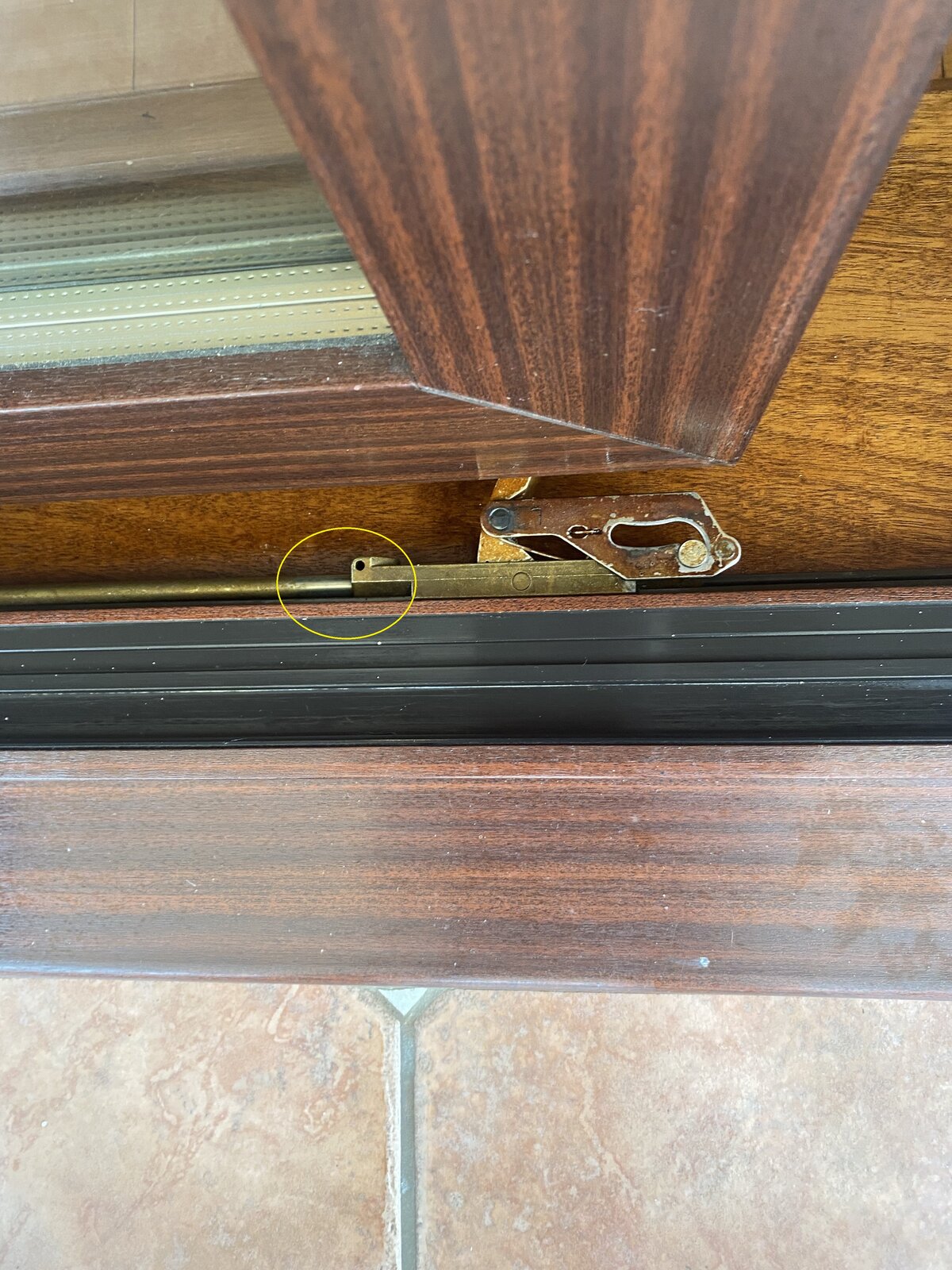

I believe I have a HKS100 ( maybe ? ) tilt and slide mechanism which is problematic - the door sticks on the right hand side and it looks like the connecting rod isn't fastened to both mechanisms ( see circled on
img_1225-copy-jpg.359968
picture )
Any ideas where I can get spares / installation manual etc
Thought I start by reconnecting the rod
Thanks in advance for replies
I hate tilt and slides! A lot of the older mechanisms are not available now . Dgsupplyline might be able to help but last time I tried to get an older part 6 months later it still hadn't arrived and I cancelled the order!
Strangely enough I went to have a look at one today, took one look and politely walked away, the bogey wheel release spring had gone, the bar was pulling out, the track was sagging and screws pulling out of the frame, DG Supplyline, North west Hardware are your best bet but parts for these 80/90s patios are getting hard to find and also finding someone who's willing to work on them and not worried about buying someone elses problem or opening a can of worms, I tend to remember which jobs looked simple during survey but then bit me on the arse later and tilt and slides are one of those
