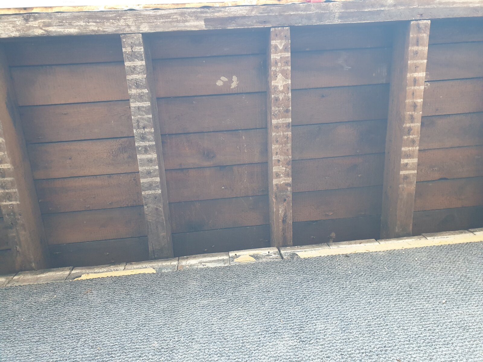

Hello all,
I have to replace the crumbling lathe and plaster on our square bay window in our bedroom before the plasterers come to skim all the walls and ceiling.
I would like to insulate the cavity while I have access, but what do I use without causing any damp issues?
I was thinking sound insulation slabs from rockwool?
Please advise.
Many thanks
Karl

If the frames are timber then you should use a breathable insulation. Celotex will work, but does rely on a vapour barrier at the outside of the structure to prevent condensation in the middle of the wall. Google for wood fibre insulation, as it is a bay window you will not need to buy a lot and any "internal to the wall" condensation gets a chance to diffuse away.

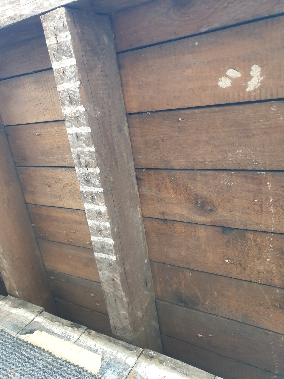

So all the lathe and plaster is off, void is 100mm deep.
Looks like timber cladding on the outside then I guess batons with L&P render over that.
I was thinking about the vapour barrier, pointless doing it from the inside.
So surely drytherm cavity wall insulation would be best?
Drytherm or Wood fibre insulation will both work, work out which gives the better insulation value and/or which is cheaper, they are both quite easy to cut, but the dritherm will tend to blunt your knife/saw more than the wood fibre will do.
