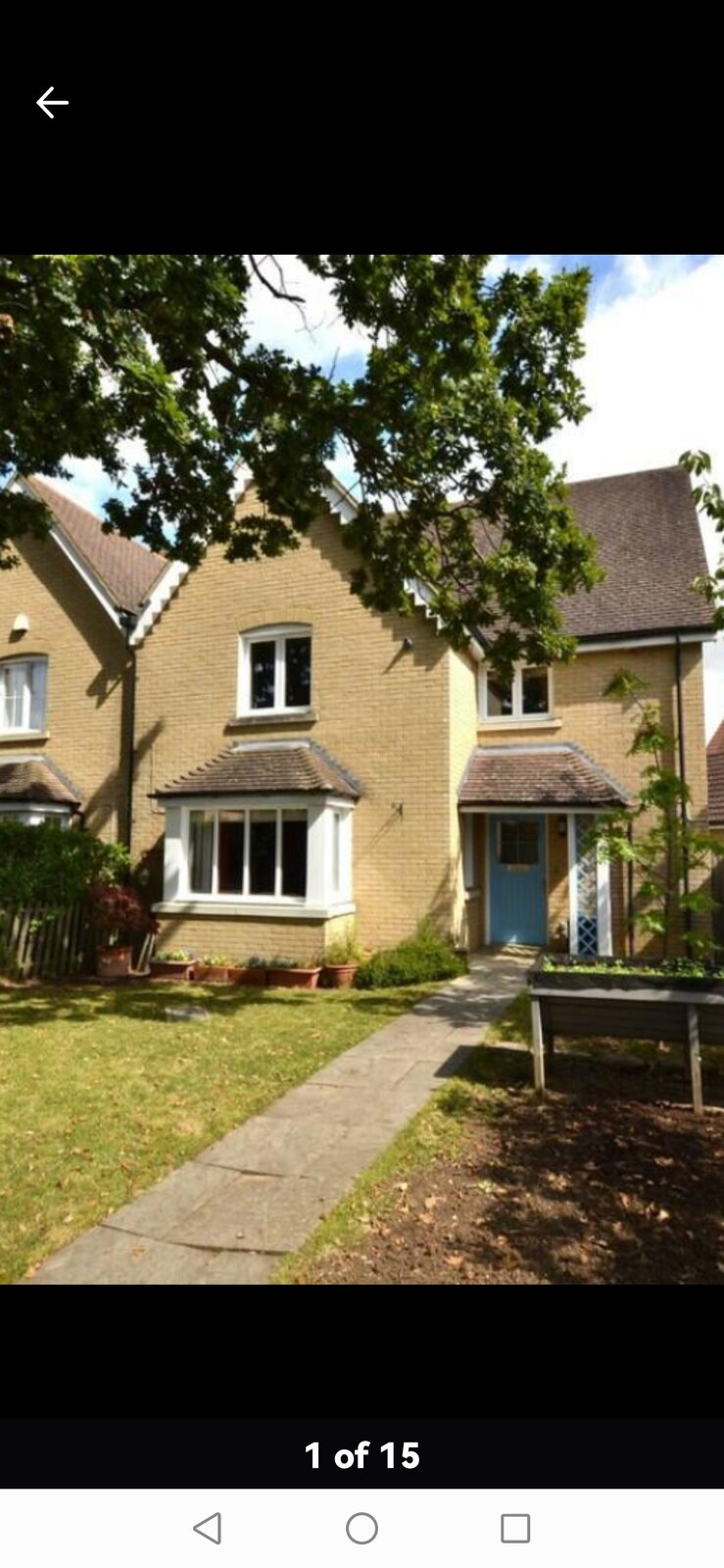

Hi all.
Didn't know where else to ask, other than googling
Looking at buying a house and saw a lovely one for sale, out an offer in and then was told after the offer was accepted it's a timber framed house (shows my level of knowledge or lack of)
Read pros and cons to a timber built house online
But figured some of you guys would know more. Is it worth considering a timber built house? It was built in 2006, by main concern was rotting and future lenders when remortgaging and issues of maybe selling it in the future.
Also read about potential rotting etc too
Just wondered if anyone had thoughts on whether to avoid or if I'm overthinking it
Many thanks!

I found out it was built by countryside residential if that helps
This is true timber frame
I would hazard that if it's a brick external finish then it will be traditional timber frame (internal skin) and then a brick outer leaf. If rendered then it could be traditional with render on blockwork rather than brickwork or SIP's.
