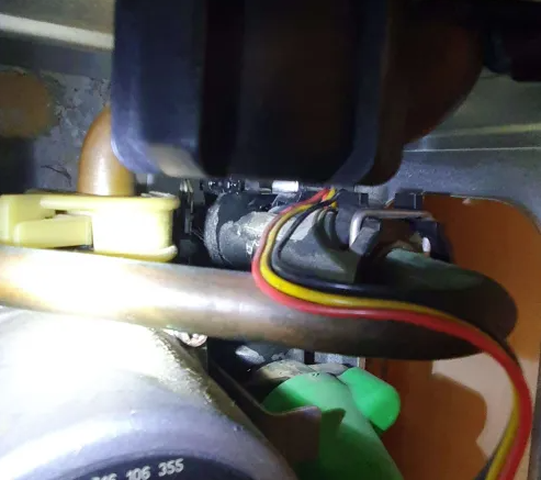

OK so my WB Greenstar 25SI 4731184NG has now sprung a leak in the manifold that is above the diverter valve.
piddling out a fins spray of water.
So seeing as I have seen lots of FB ads about getting free boilers if you have someone on benefits in the house (I have) and if the boilers over 15 years old (mine will be at the end of April) can I qualify for a new one and will they fit a gas combi or does it have to be the new heat pumps?
This is the part that's leaking, what's it called please?
I may as well see how much that costs to replace too.

OK so some searching shows this part as the return manifold.
Now I know what it's going to cost to repair.

That is repairable, very cheaply.
Do tell me more please?

OK change of plan, I bought a new manifold & will change it at the weekend.
I'm going to upgrade all the radiators & piping then when all done get a new boiler fitted by someone else.
Return manifold replaced.
Change the main heat exchanger and the boilers practically new, I have replaced so many other parts :)
