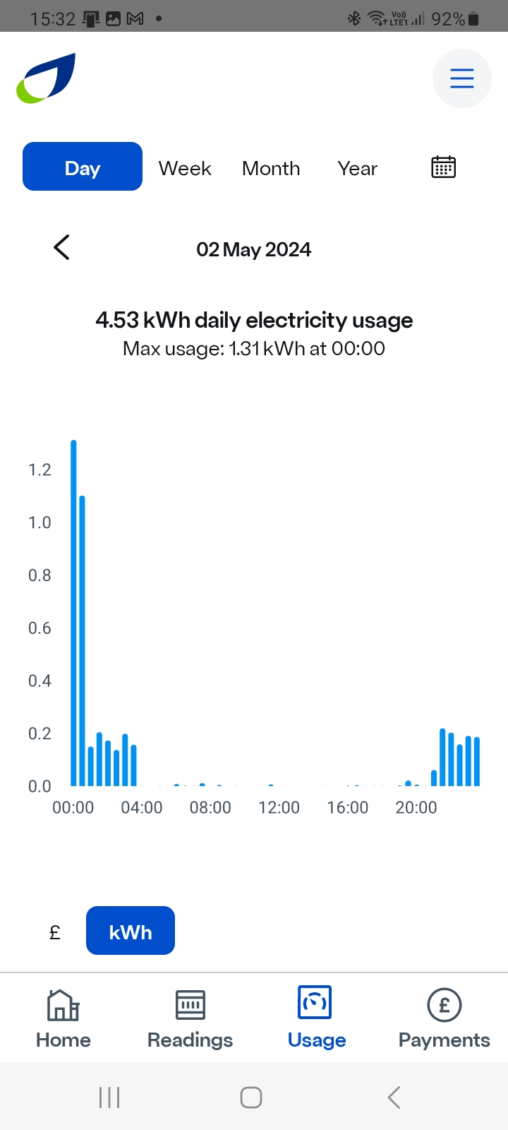

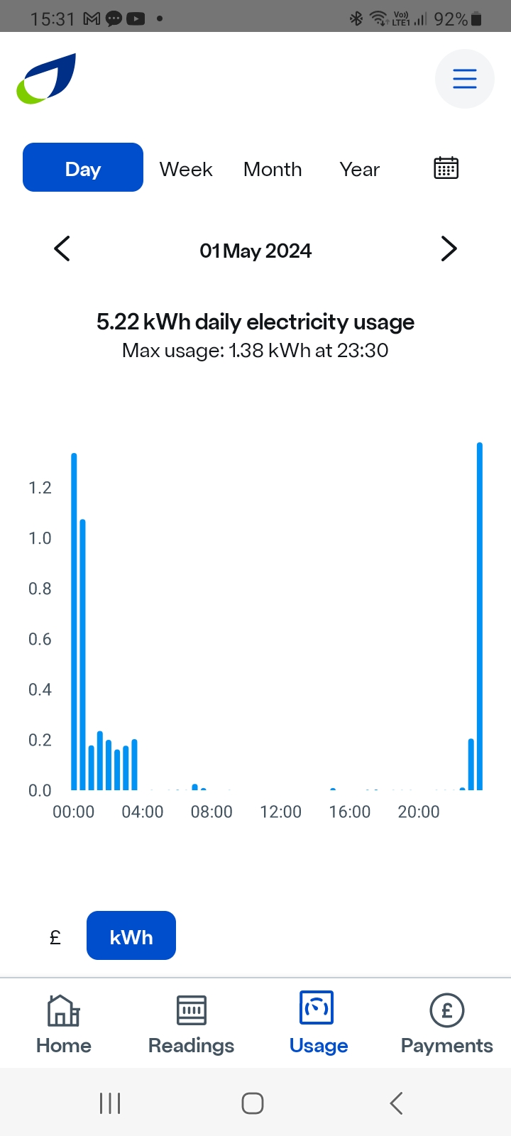

I got caught out, I thought it was daylight saving time, seems however looking at app it is UTC so have lost £7 due to setting battery to charge too soon. On another forum I got the replay

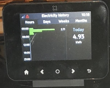

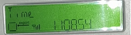

So what is the default for time, do we need to say BST or DST or UTC or GMT every time we agree on a time? However I only found out by looking as the British Gas app, 1714813626496.jpeg I noted high on the right, now changed times I get this 1714813688933.jpegthe £ option never seems to work, not since split tariff has been used, well one day I did get a cost, but that is now rare, to reach meter it is a stand on a chair job, and I need to go outside and down a set of steps, so now smart meter fitted I do not read it any more. Not sure I even know how. Did expect the in house display to show how much at each rate, but no, and anyway the IHD shows BST 1714814663887.png so only the app shows as UTC, that 4.93 kWh shown for today will likely stay the same until around 9 pm on most days in summer, some days even lasted until after midnight. Was solar worth it, it will depend on if I ever get payment for exported power, at moment still waiting.

That is up to the discretion of the Meter Operator. Although when the Meter Operator buys electricity for their customers, the price is set in £/MWh for each 30 minute period through the day, with Period 1 beginning at midnight UTC. We do the same for the electricity grid - everything collects alarms and data in UTC, then the times are adapted for BST for display to the grid control operators back at the control room end of things. If you don’t do this, you either have an hour gap of data, or an hour of duplicated data when BST kicks in or out.
