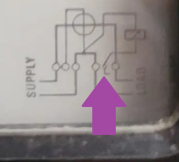

No, those are 4 wire meters and just switch to one register or the other, so whatever is used is either at the day rate or the night rate. They do not have any load switching capabilities.
The meter registers are changed over by the 5th terminal on the sub meters
There are either timeclocks at each apartment, or a central one which switches the storage heaters via individual contactors. Possibly in one of the grey cabinets where the modern meter is.
