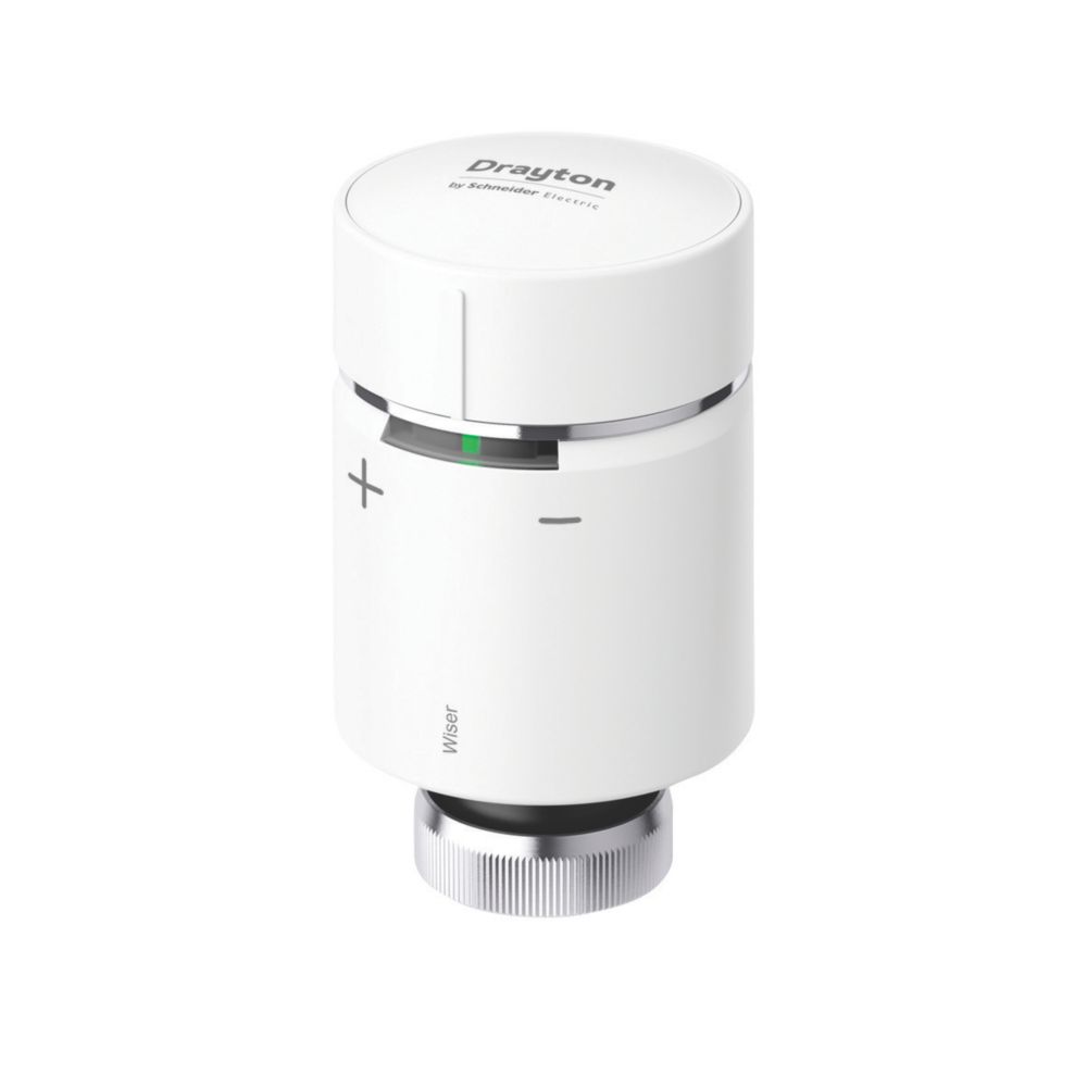

and although the former only cost me £15 each and the latter £36.50 each I find the former in general better, I believe the best is this
9953V_P
the Drayton as it have algorithms to work out when to switch off, but as to if worth £44 each not so sure. So I will start with the Energenie which was the first ones I bought.

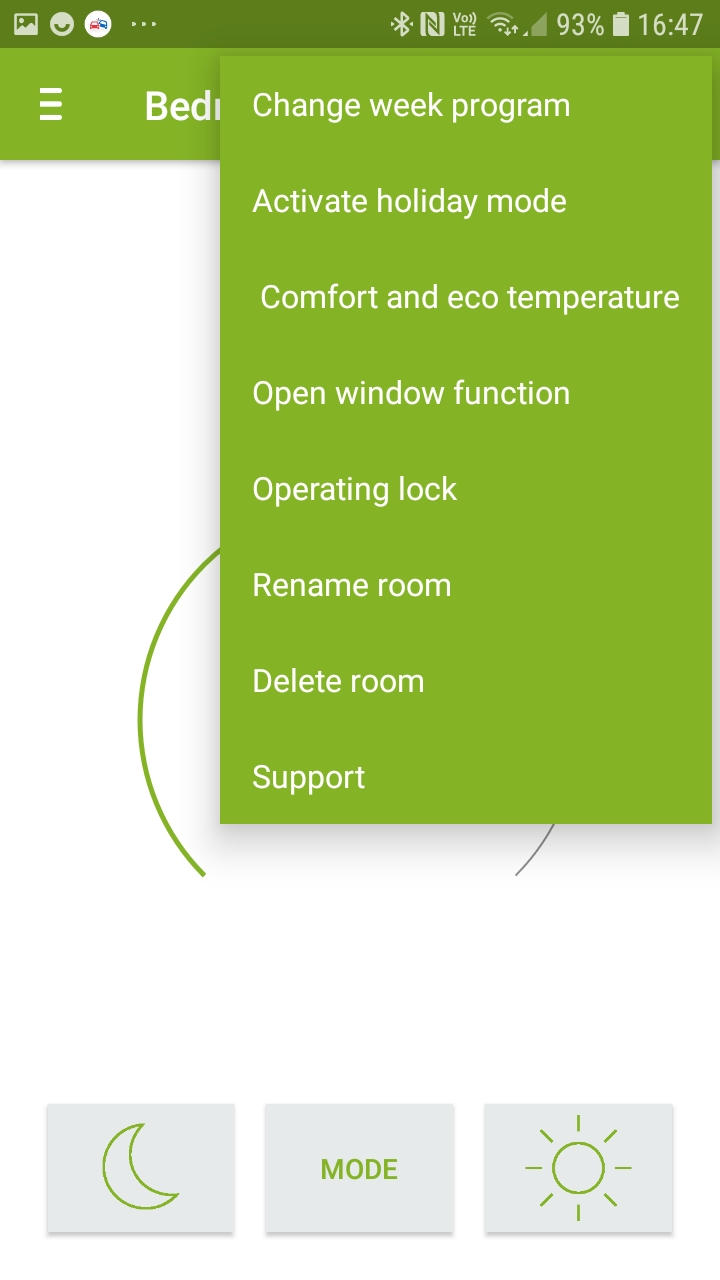

The eQ-3 much cheaper the bluetooth Screenshot_20190726-164748_calor BT.jpg does make setting easier, but unless two TRV's in the same room not really required, as everything can be manually set, I have seen manual version down to £10 each, it has window open detect which is not on the more expensive energenie model and I find I don't use the phone once set, the right button swaps from eco to comfort and back so I just press the button if I use room early.
The bluetooth version will only link to one phone, so wife controls 2 and I control 3.

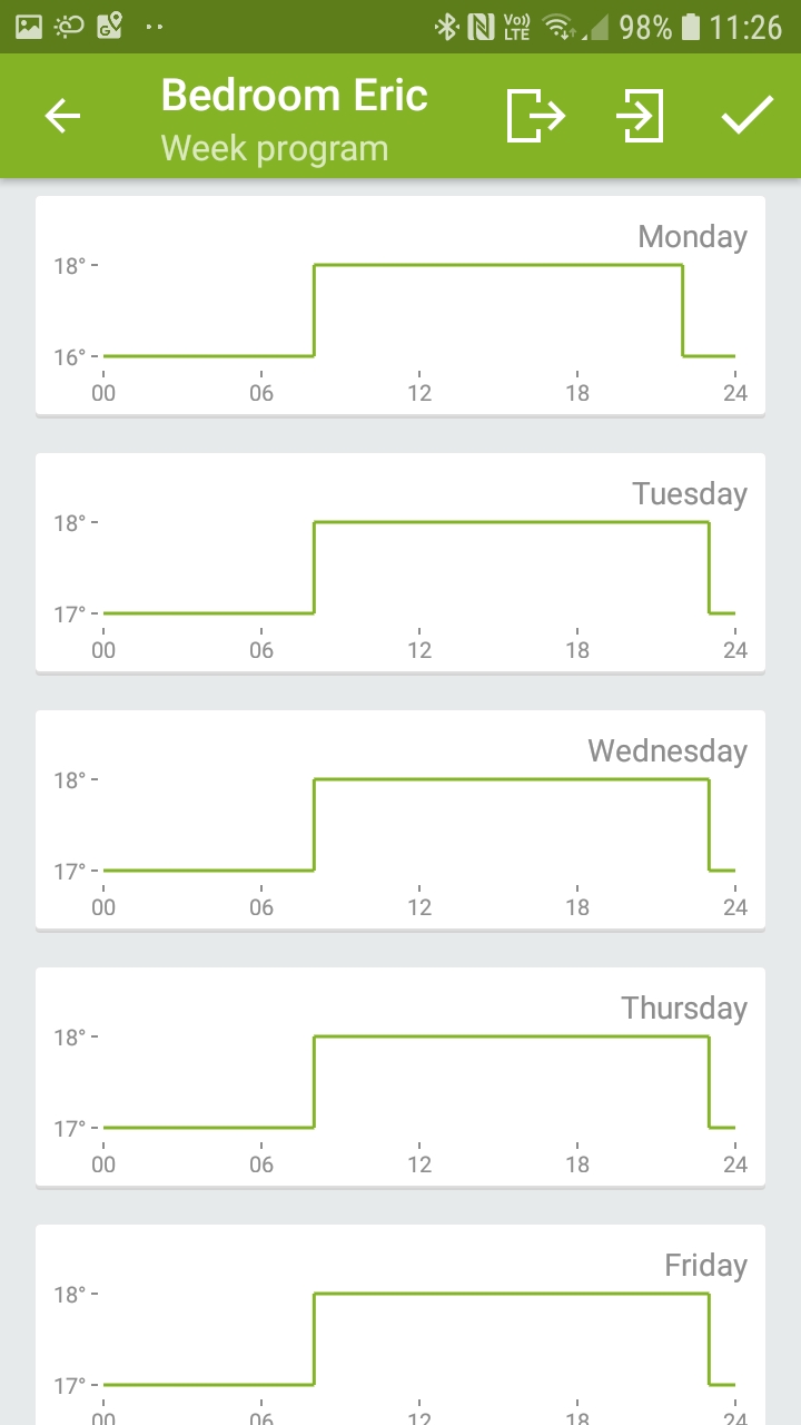

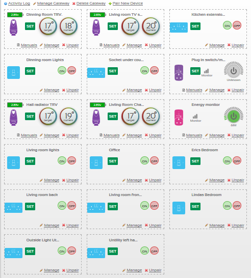

There is a huge difference in what I can do with each TRV head this Screenshot_20190725-112626_calor BT.jpg is the schedule for the eQ-3, but the energenie has many more options the base screen Over_all_report.jpg even more now this is an old screen shot, in theory using IFTTT I should be able to link the TRV current temperature to the plug in switch/monitor which in summer controls my portable AC so should be able to auto start/stop the AC unit depending on room temperature, however the AC in the two years we have lived here has only ran for around 5 weeks, so hardly worth automating, I just look at room temperature before returning home and it temperature high I manually turn it on.
And this is the thing about central heating as well, how much automation is really required, cooling or heating it takes time, and Nest Gen 3 seems to work out when to turn on the heating before my return, but the energenie mihome did not have such complex algorithms, and as said I cheated to get rooms to temperature, the same now with simple eQ-3 by setting times with just 10 minuets delay between the TRV's switching on I can ensure first kitchen, then dinning room and then living room are heated, in the order they will be used.
