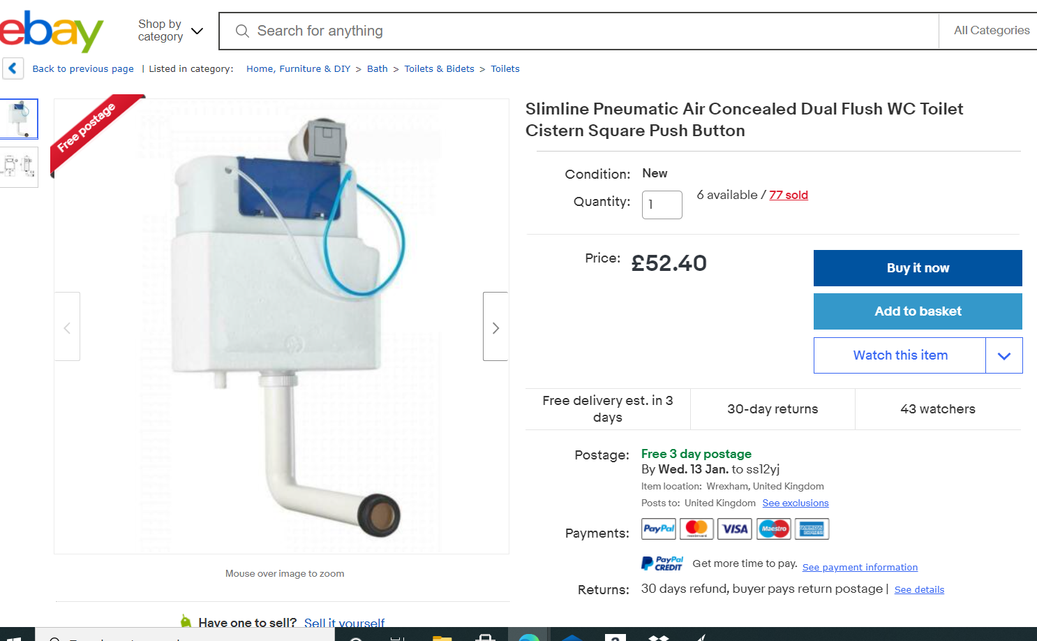

Yes workable, you could fit air flush valve as the hoses are more than 300mm long or can be extended.
Thanks - I cannot seem to find longer hoses, can you give me a link or a clue as to what to search for please?
There are also slimline cisterns- often plastic so not everyone's cup of tea.
