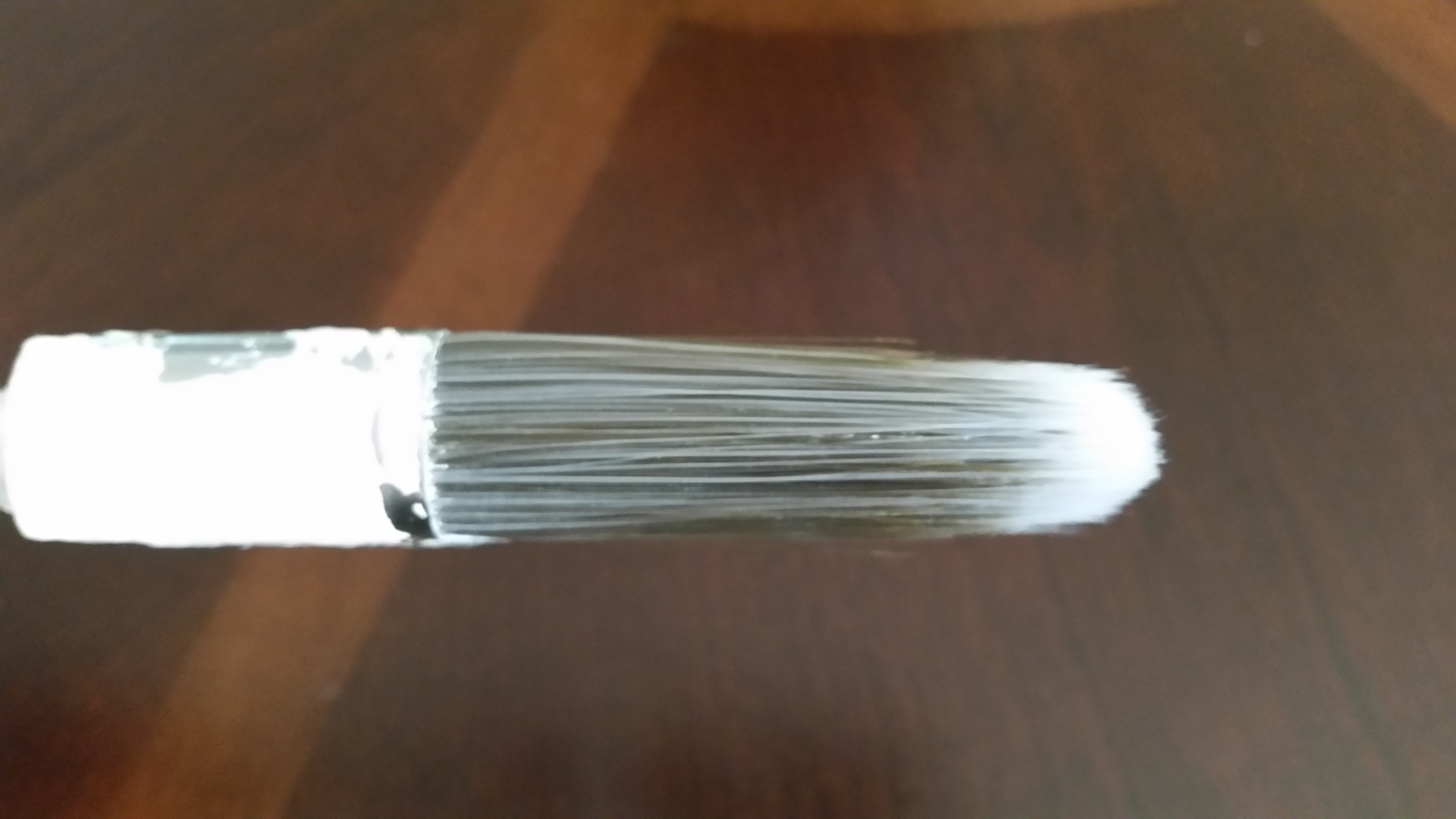

I googled "chisel-tipped synthetic brush". Are you meaning just an angled brush?
I have one already in which i got for a job that wasn't so important. Bought it from Wilkinsons so it's only a cheapy. The end while angled is very beefy.
I bought a set of Purdy brushes for when i was painting all the interior woodwork, but no angled brush. They were great to work with & worth the investment i thought.

No, I don't mean an angled brush, although the one in your link would be suitable. By chiselled tip, I mean that the bristles of the brush come to a point in the centre at the very tips, as opposed to the 'beefy' tip that you refer to. If you already have synthetic Purdy brushes, one of those will be fine, and you should be able to understand what I mean if you take a look at the tips and compare them.
EDIT
This is one of my 2" Purdy's which, although worn, and a few years old, you should be able to see is narrower at the tip than at the base. Maybe 'tapered' would be a better term, but everyone I know uses the term 'chiselled'. Not sure why I can't load the image as a thumbnail today. :confused:
