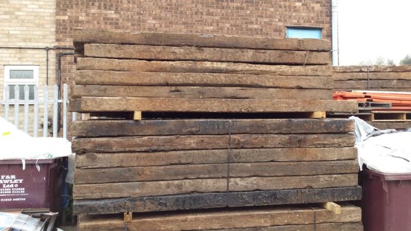

I never realised there were cheap ones and longer duration ones. Here's some photos, I think they look tired and going to replace with the other picture, the top sleepers as they look less 'cresoted'. I can't decide if I am making a job where one is not needed but the sleepers are rotting.

Top pic looks like 'new' style or non original sleepers. Bottom ones look like 'proper' sleepers! You can tell because it looks like the top ones are more uniform and have gone grey. The ones you are looking at wont go that way, if they do itll be in many many years

Thanks guys, this place is really helpful. The sleepers in place are rotting, you can see clearly on the longer one next to the shed but they do ooze cresote and have bolt holes in which is odd, that suggests they are old and not new dressed as old?
I am going to get 6 'new' ones then from the yard above, 20 quid each (2 around the patio) as below.
One question, the ones around the shed are sawed to fit but all the sleepers are 102 inches long down the yard. Do you get different lengths so I can fit exactly?

If you buy longer timbers, and cut to lenght, aggressivly treat and then seal .cut ends
