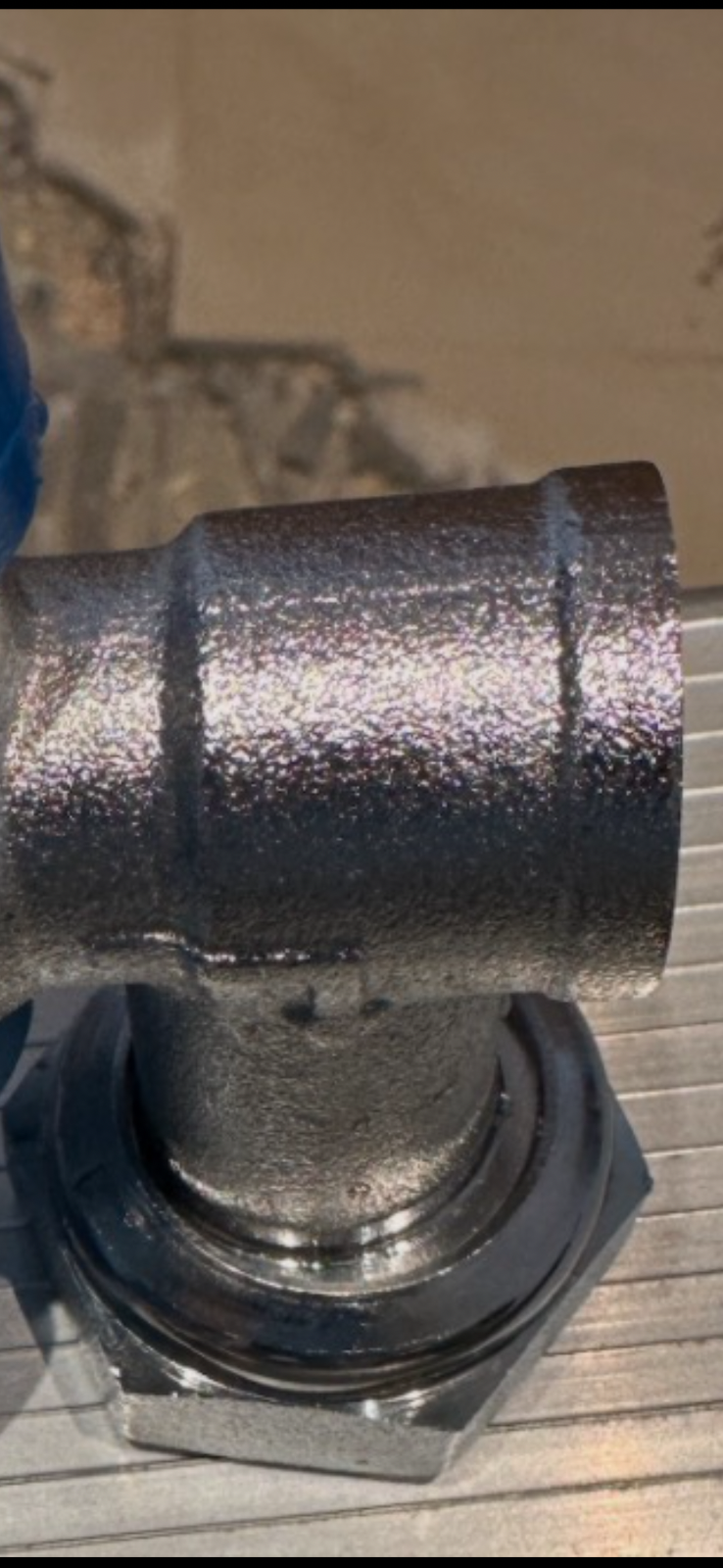

I’ve attached a few pics. The two faces are flat and they provide this really thick black rubber that’s the exact size of the flat surface. But problem is the the main nut that comes and tightens to the body doesn’t not have anything that keeps it perfect centred so I think it just doesn’t sit perfectly. When I remove it I find the rubber has ended up outside the flat surface into the threads.
Also, please see the the pics below. I think there is something fundamentally wrong here. That bit that goes to thread into the body is supposed to surely sit perfectly centred to that body metal ring. I hope that makes sense. But if you look carefully you will see that it doesn’t. Unless the nut is never supposed to go in enough to need to self centre with the inner part
Just a thought. In your first picture the rubber washer appears to have a lip to it. Is it the right way round or is the narrow diameter meant to go inside the fitting with the broad back of the washer against the flange?
So I’ve managed to make it work without leaking so far. Keeping an eye on it for the next 24hrs see how it goes. But definitely think it’s very poorly designed. I had to completely removing it and have someone hold the two fittings 100% straight while hand tightening the nut. Making sure the back view looks evenly centred. After doing that i installed it back to the compression fittings and just slightly tightened with spanner and it seems to be ok so far.
Surely they could have machined it so that the nut always stays centric rather than wobbling about and dislodging the washer which ends up then pulling the washer into the threads

Was doing ok for a few hours then just a little movement on the pipe while working then started leaking again. Tightened it a bit further as it’s not tight tight then stopped again. But same thing happening on cold side but every so often starts weeping again. Not really confident with this rubbish lol.
Considering the back of the mounting doesn’t self centre it just makes itself wonky somehow

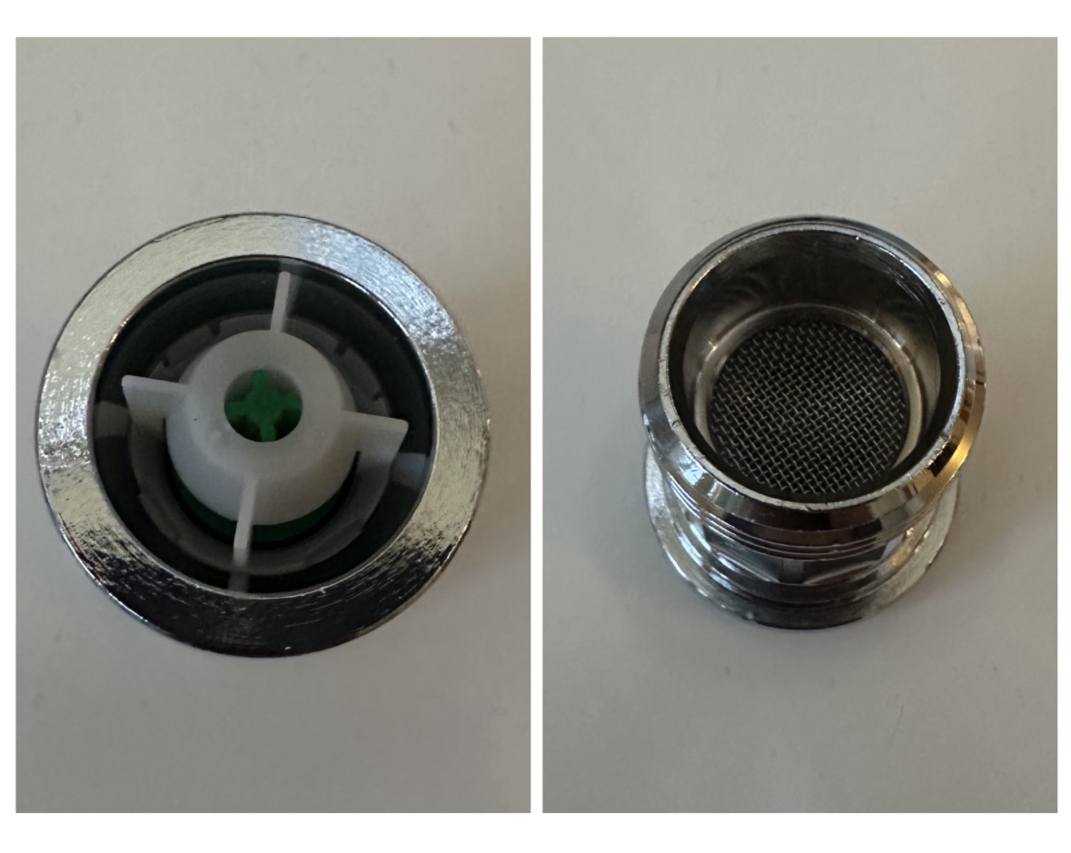

So I bought a pegler brand one now. It doesn’t have isolators so I’m going to need to add isolators inline to it. But I’m trying to figure out if it has inbuilt non return valve or if I should get an extra non return valve. Basically it is this two sided thing pictured below one on each inlet one side of it looks like the metal mesh strainer/filter thing and the other side maybe it’s a non return valve? Can anyone check pic below and see if this is indeed also a non return valve. The picture is of the same fitting just two angles of photo.
Blow through it and see.
Just did that. Blowing through the filter mesh thing you can feel a valve opens as you blow and blowing from the other side nothing comes out. So it is a strainer filter plus non return valve in one component. This one seems a lot better constructed though specially the way the inlets stay perfectly centred at all times regardless of the rubber seal. The problem with the other one was it relied on me getting it 100% centred but then nothing was stopping it dislodging itself and leaking.
